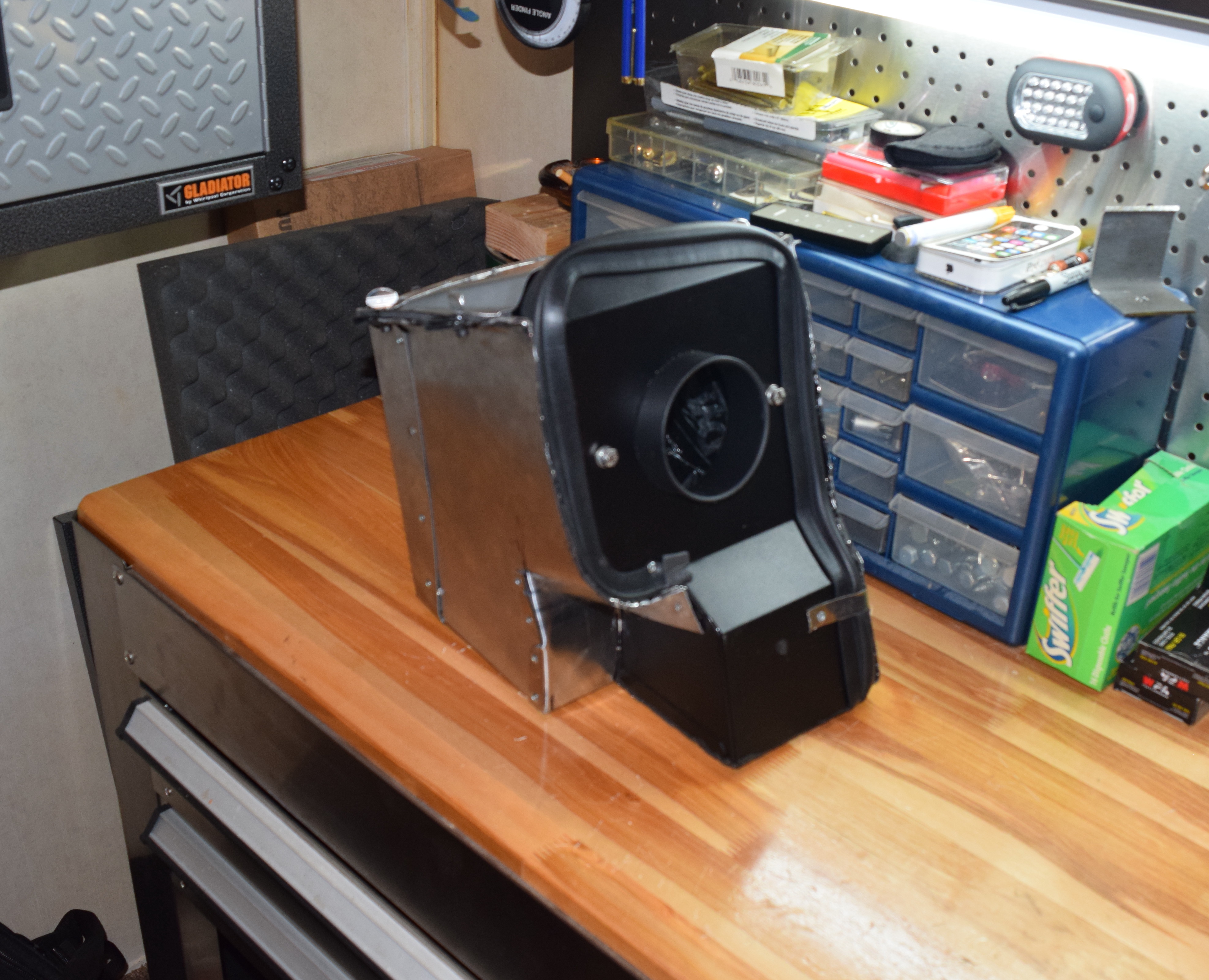

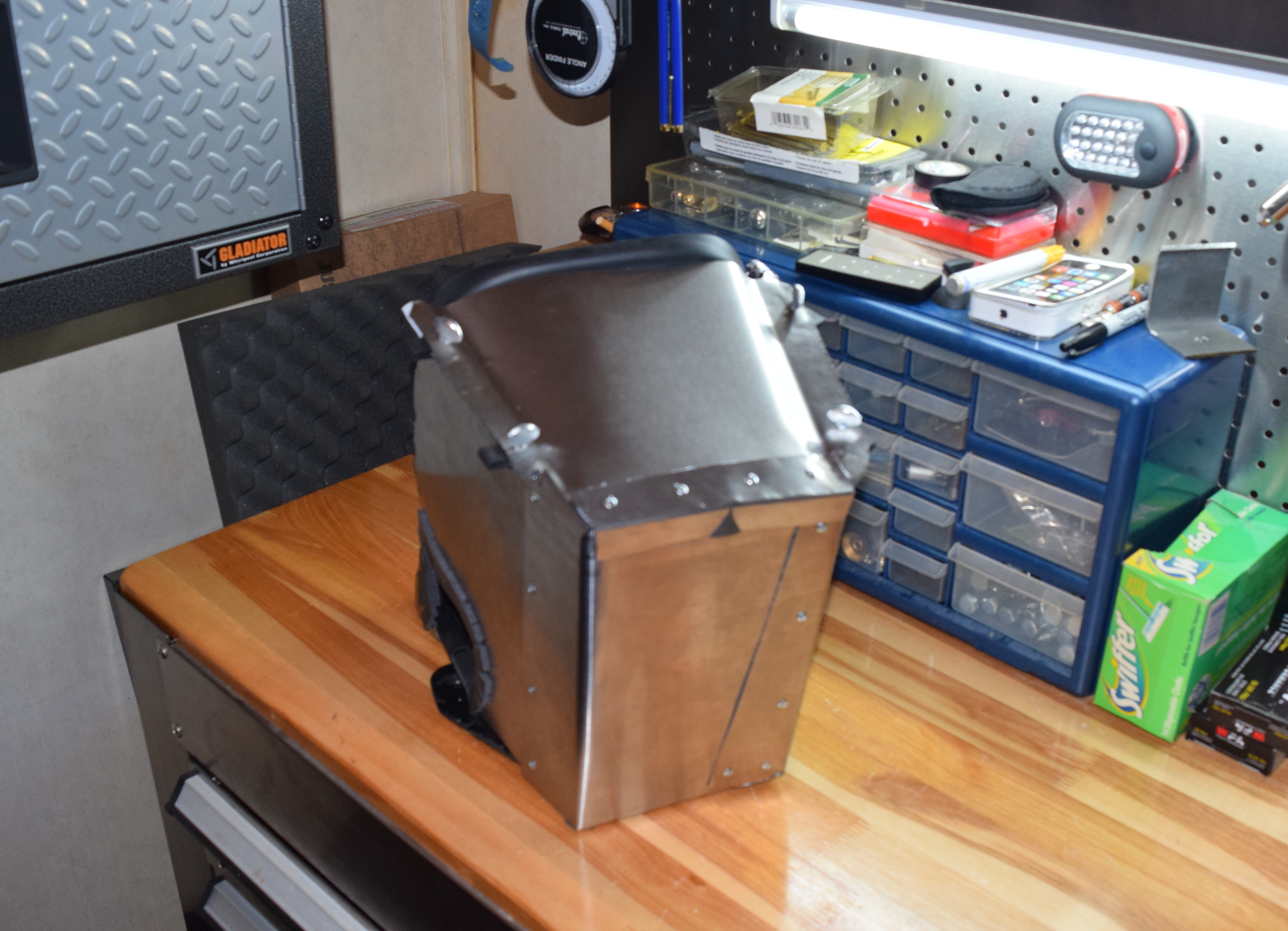

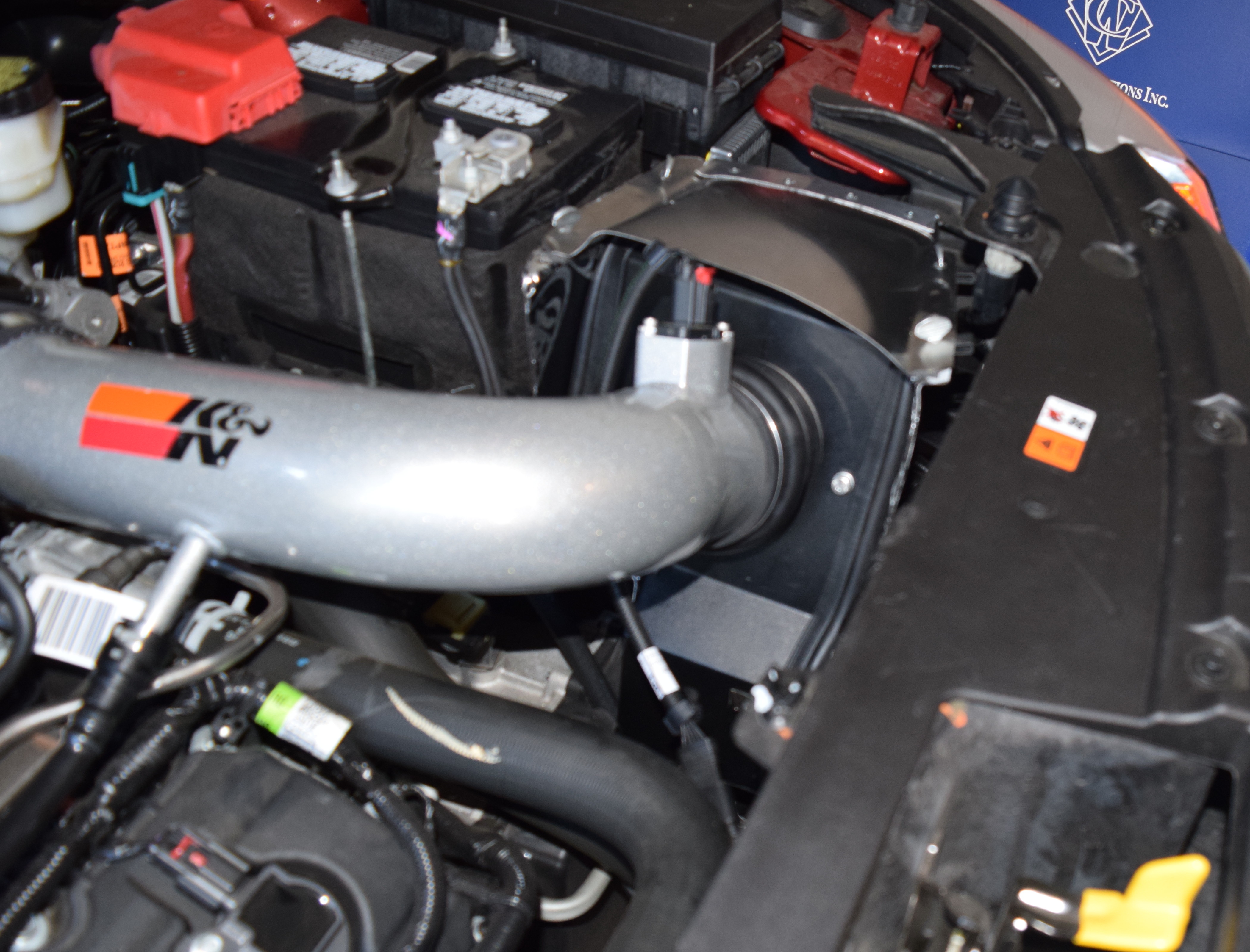

Did you say...Cold Air Intake Box? :D I bought a K&N CAI assembly about a year ago and in the time I've had it installed, I couldn't help noticing how half azzed engineered it was. Mainly the exposed air filter to the engine bay. I thought, how could K&N call this CAI? Anyway, I have remedied my situation by cobbling together a seat of the pants engineered, cold air intake box (from the mind of Mikey:D) to enclose the air filter from the elements of the engine bay. I will be installing it today. Later, in this post, I will present pictures of my cobbled creation for your edification. My materials used was a sheet of stainless steel 'backsplash' acquired from Lowe's, Dynamat to insulate and deaden sound, flat weather stripping for a good seal in needed places and I used rivets to hold it all together. I used the air filter frame supplied in the K&N kit as the base for assembly. The OEM air intake duct was also utilized.:thumbsup:
As promised, here are a few pics of the new CAI box before and after install. :chug:

Nice job on the modified cai. Should help pull slightly lower temp air vs the original Cai design.
Thanks, it was a fun project and it seem to be doing what I set out to accomplish. The noise the K&N system was creating was quite annoying to my ears and so, this box, being insulated, has shut that down to a large degree. Second, the design of the K&N for the Ex is quite poor in my opinion and it still has it's problems that I hope to remedy in the future. Because of the design, the filter bracket is actually bent forward past it's natural shape forcing the filter down. Since there's no sealing off of the filter from the engine compartment from the bracket being pushed forward, there is no seal against the hood when closed. As I said, a poor design. The 'cold air' part doesn't exist as the filter is fully exposed to the heat of the engine compartment. You can see this effect in the last photo as that bracket appears to be shoved into the 'cold box'. The bracket should be flush with the back edge of the cold box. This is due to the tube being too long. However, I took this into consideration before I built the box and made it adjustable to the condition. When I figure out a way to shorten the tube, this condition will disappear, hopefully. As it is, it works fine for now. Being as the filter is now completely sealed from the engine compartment and air is ducted from the outside into the box, it more resembles and operates as a cold air intake now. However, I like many, don't believe a cold air intake does anything for the Ex in regards to performance gains but, it does get colder air now. Having a Livernois 93 tune on it helps in the performance department more.. In a couple of weeks, I'll be taking it down to get dynoed to see what changes have occurred in regards to performance numbers.:thumbsup:

That homemade CAI box looks too restrictive IMO.

I can assure you, it is not. It has improved the already good throttle response (provided by the Livernois tune), IMO. It also has plenty of room for cold air to circulate all around the air filter without the heat of the engine compartment contaminating it like that of the original design. After all, that's the idea of a cold air system, isn't it?:thumbsup:

I have no evidence to prove one way or the other that a CAI on a 3.5L N/A engine in a Explorer will have any gains. When looking a the K&N design on its own, I would say, it's a waste. My initial reason and what is still the main reason for my installing one of these was to open up the area around the transmission for easier access around that area and it also looks better than the stock set up. As I've said previously, it bothered me that the K&N was so poorly designed for a CAI that adding a cold box would/could only improve it to at least resemble a CAI. I believe I was successful with what I did. I believe adding the K&N only succeeded in generating a loud, obnoxious noise under heavy throttle, even medium throttle. By adding the cold box, the obnoxiousness has been neutralized. It has a much more pleasant noise under those conditions now.
