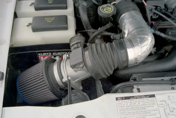

Here's what I've been working on and just need to get it prettied up and sealed to the hood.
Like 410Fortune said if you route cold air to th filter and help box it off from the engine it "Becomes a cold air intake...That is why you see the box thing around the K&N filter intakes. I was thinking about getting a hood scoop to "help" cool things of in the engine compartment. Initially the scoop would not be connected to the cone filter, but eventually I could come up with a way to route it over it. I'm just thinking that any added air flow can only help cool things off under the hood.
