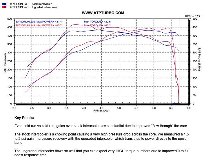

The logic that is built into the EB platform will autocorrect if you will. There are no gains that will be had on a stock tune. The ECM will not allow for deviation from what it is told parameters should be. That car in the graph has a tune, no doubt.
what is the stock boost and how much more does a typical tune add....
Stock boost is limited by the factory 2BAR MAP sensor to >14.9#. There are factory spikes that already exceed that threshold. So with our 3 BAR tuning we are mostly taking advantage of the car's engineering, and turning it against itself to apply the additional power that is otherwise lost.
doesnt 2bar equate to 29psi or so... so youre saying that the 2bar isnt enough... not sure if I read that right..
You are confusing gauge and absolute pressure. The 2bar sensor reads to 14.x psi gauge, which is about 29psi absolute.
2bar map sensors read 1bar of vacuum, 1bar of positive manifold pressure. 29.4psi of capability. 3bar would give you 44.1psi of capability, 2bar of positive manifold pressure, 1bar of vacuum.
