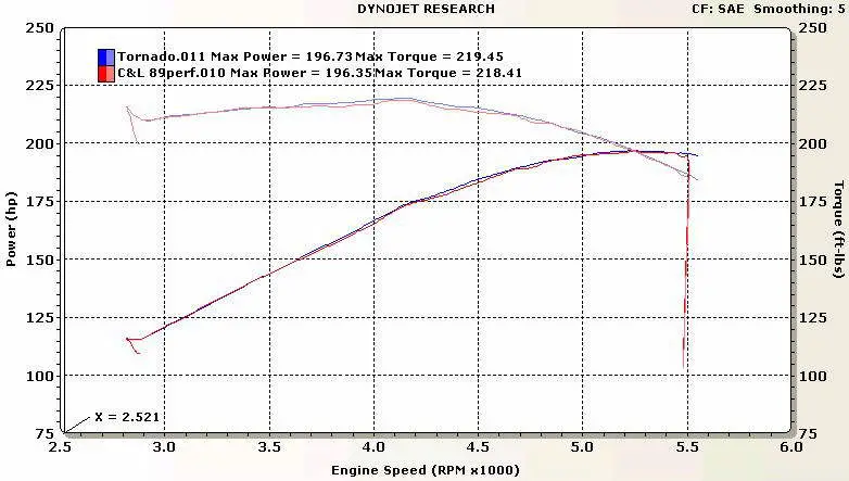

I believe someone on here dynoed an Explorer with and without the Tornado and it showed no difference. So stay away from those things. Listen to Aldive when it comes to gas mileage. 13mpg is sure low, but then again your probably doing a lot of city driving. Good luck.
Here is that dyno chart ....

So the tornado is worth basically no HP/TQ, but what about gas mileage?
I have not tested it.

A tornado is really made for carburated motors and do show some (minor) improvements in HP and MPG on them ... given the nature of fuel injection you already have those benefits inherently so you don't get any real gain ...
