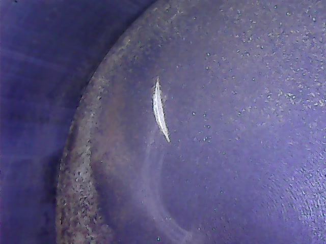

So here is what i can see with a camera looking down the sparkplug cavity.... 😭
hate to say it but your gauge may not be incorrect. you have bent valves
Yup ive put the camera in all 6 and they've hit the cylinders across the lot.... Do i even bother at this point going the repair route or do i just put another engine in....
How did you take the picture?
With a flexible camera tube (Endoscope) or your cell phone?
