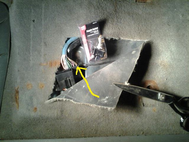

I did mine today. I followed the wires from the transfercase and went under the seat and mounted the toggle switch in front of the console.
Afterwards I checked it out in my driveway by putting it into 4 low with the toggle switch off and I have low gear with no binding in the front wheels, so I know it's working. True 2 wheel low (Cool Mod).
Under the front drivers seat.
This was the brown wire I spliced into, used same kind of connectors as for the toggle switch.
