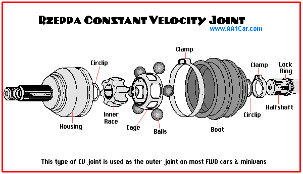

Thank you for the heads-up on that one! I didn't intend to put my metal chop saw to work on this little project. But it should make quick work of chopping off the portion of the cup housing the actual cv joint...leaving just the flange part (indicated by the arrow in the diagram). With a bit of grinding to clean it up, no balancing should be required with very little rotating mass.

Rzeppa CV joint
Update or rather, Correction to my previous reply. No cutting, grinding or balancing is required. The outer rzeppa joint is easily disassembled, and it IS Definitely removable from the half shaft.
Did you still do that now? For my understanding the circlip can not be released?
Yes they can, the circlip that retains the shaft inside the outer cv joint is similar to the circlip on the end of the inner cv joint stub. You know how you gently pry or pop out the inner cv out of the differential (inside actually the axle gear) to remove the half shaft? You are compressing that circlip into it's grove and pulling out through the axle gear. You do the same thing with the outer cv joint. However you put it in a vise and tap the shaft out, the circlip compresses into it's grove and slides out. The opposite procedure is how they are assembled...since you obviously can't install the circlip after the shaft is inserted into the cv joints internal race.
That documentation is completely incorrect on the 6. Note... They possibly meant to say that the rzeppa cv joint is not really serviceable like the Tri-pod cv joints are. While they can be disassembled, cleaned and inspected, they are normally a replacement item when they wear. But they absolutely can be separated from the half shaft.
