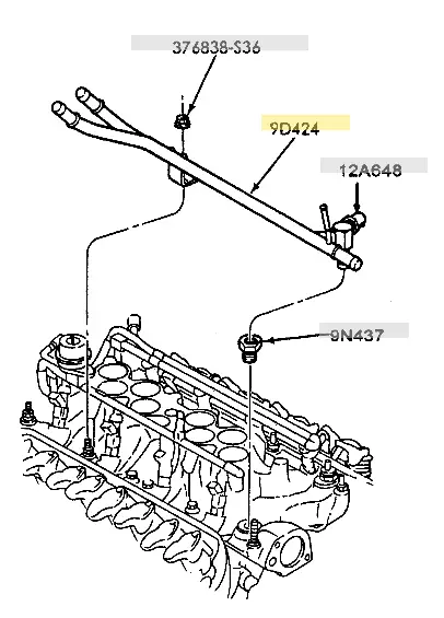

According to this diagram, it looks like the two are seperate pieces. you may be able to extract them off of the old bypass lines. I am unsure, let me know if you find something out.
In all my searching last night I did not come across that diagram.
That part number (9N437) does point to the bolt which further substantiates that these are 2 separate pieces. I have it removed. For future reference I'll attached a pic of what I did.
