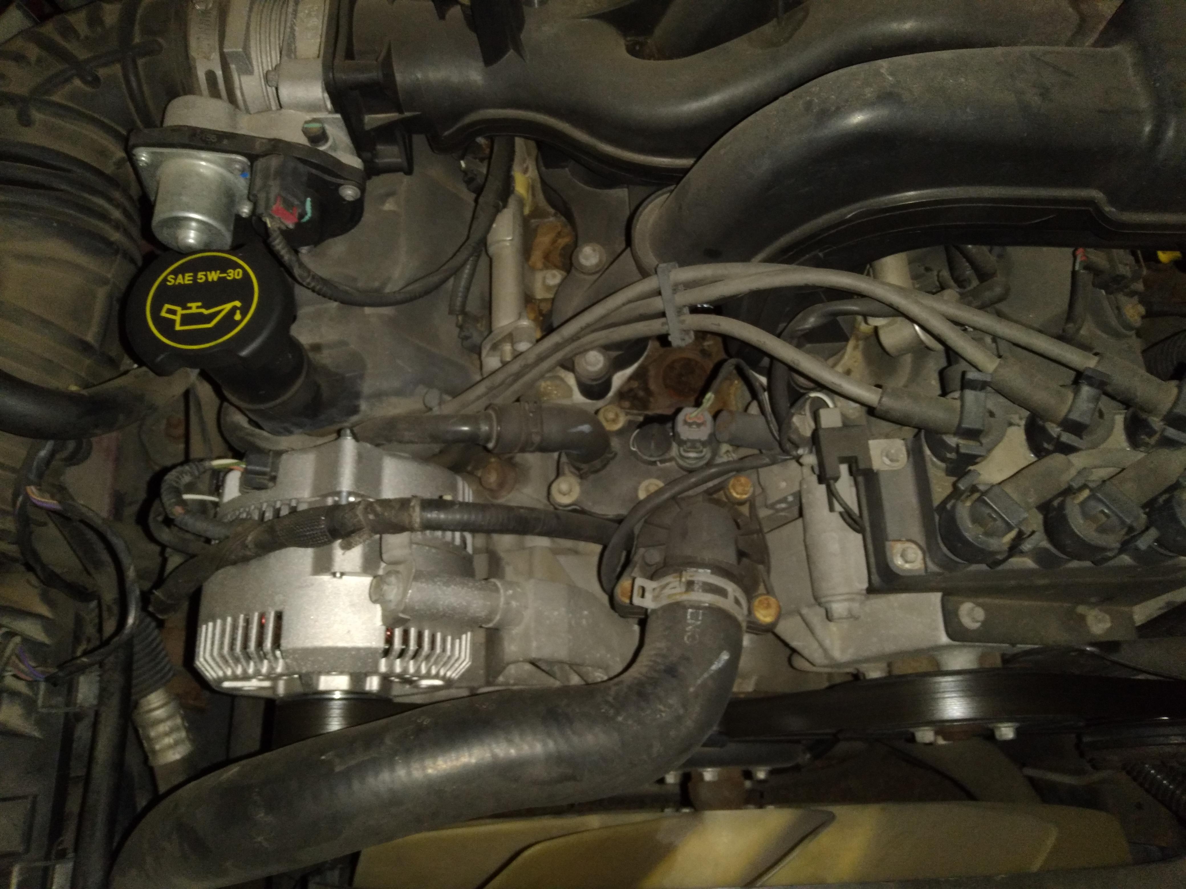

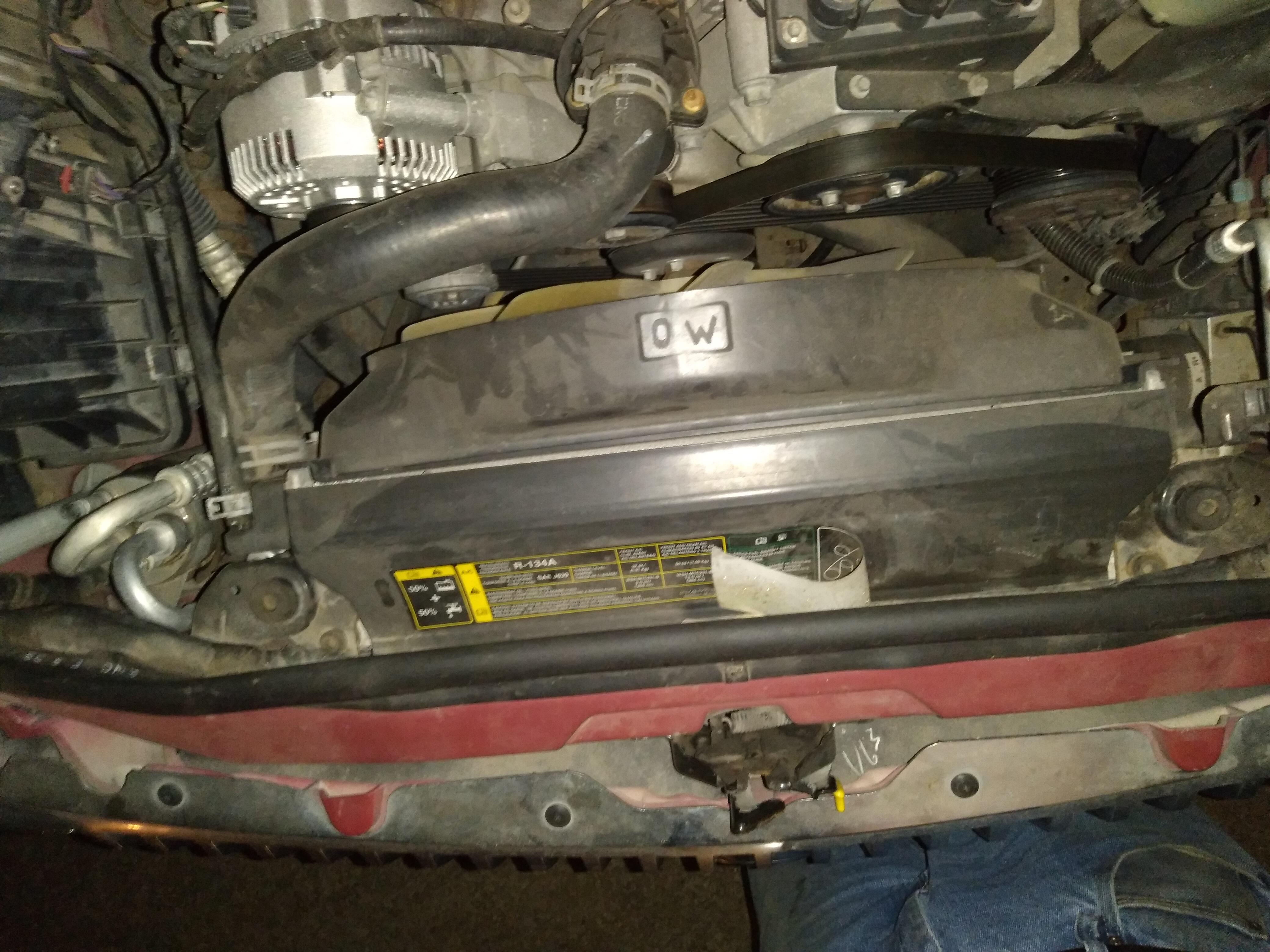

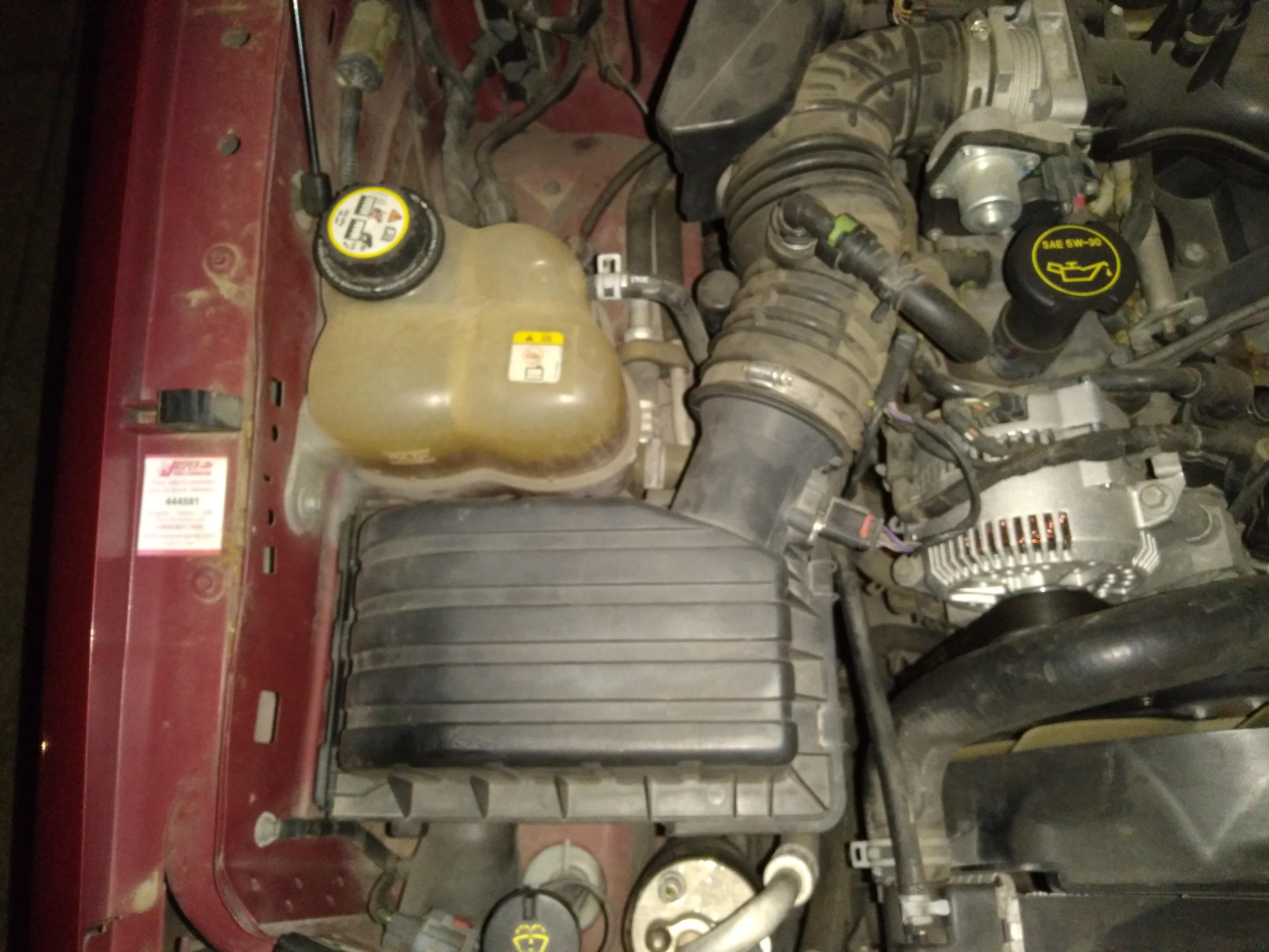

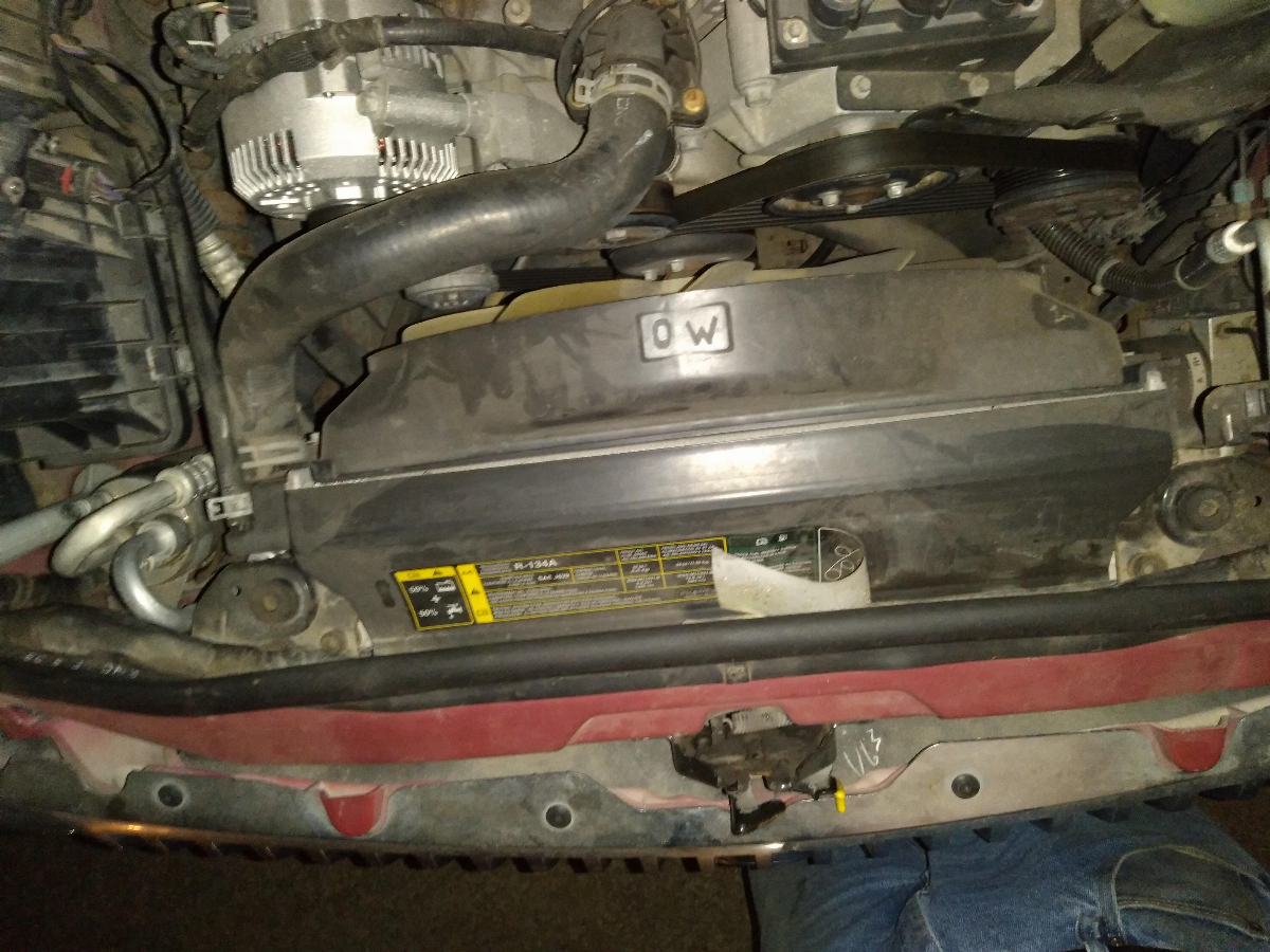

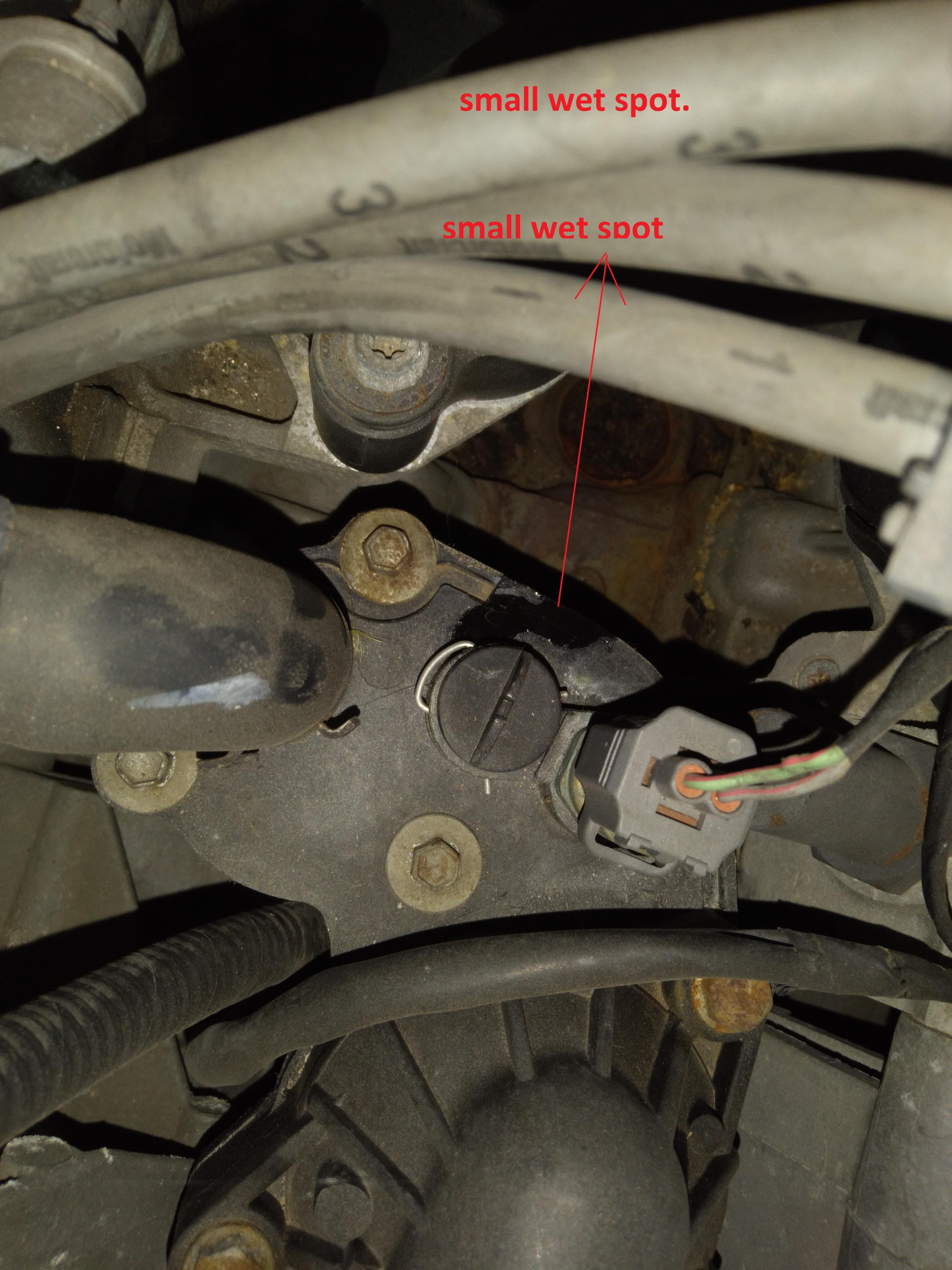

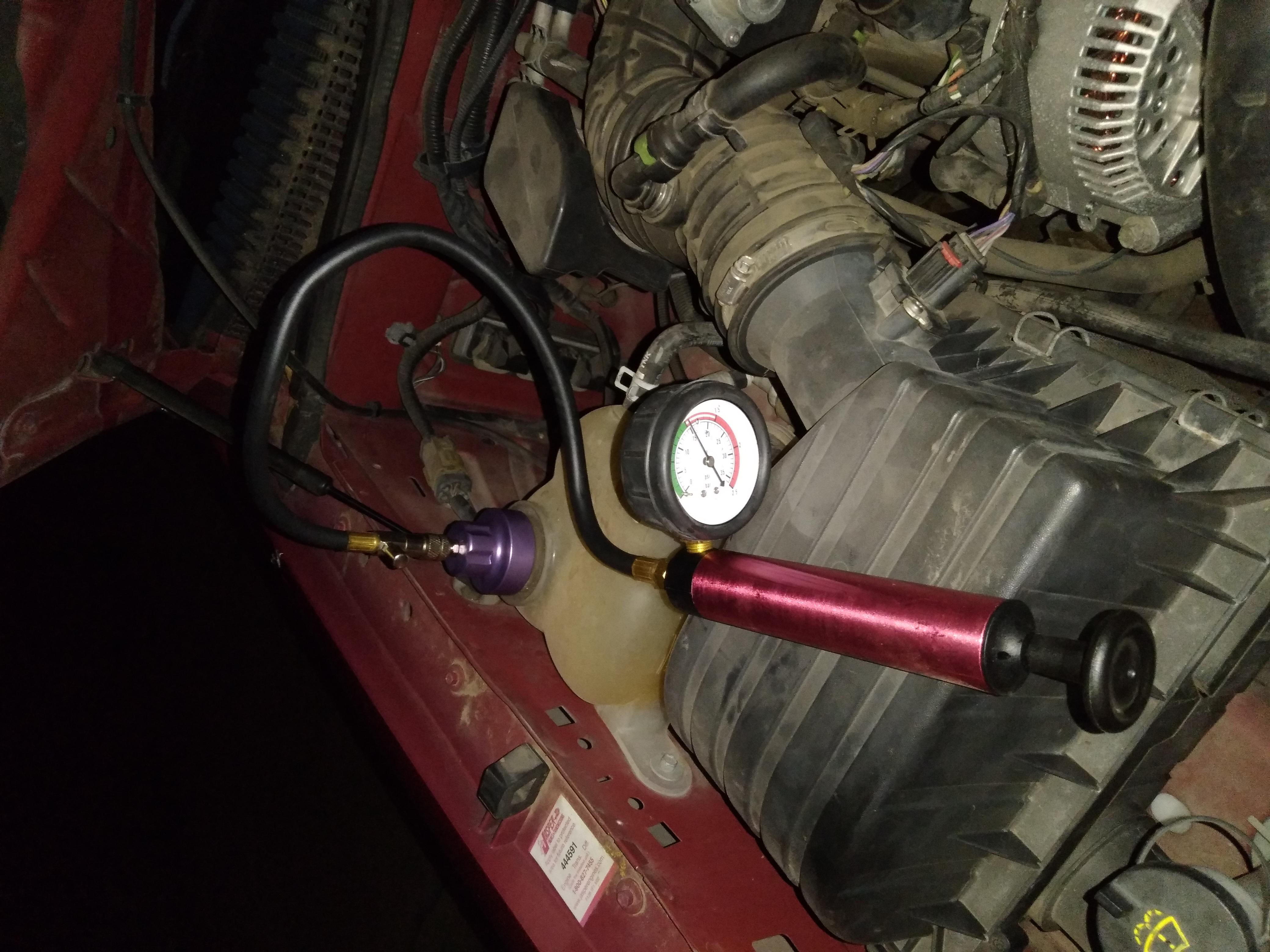

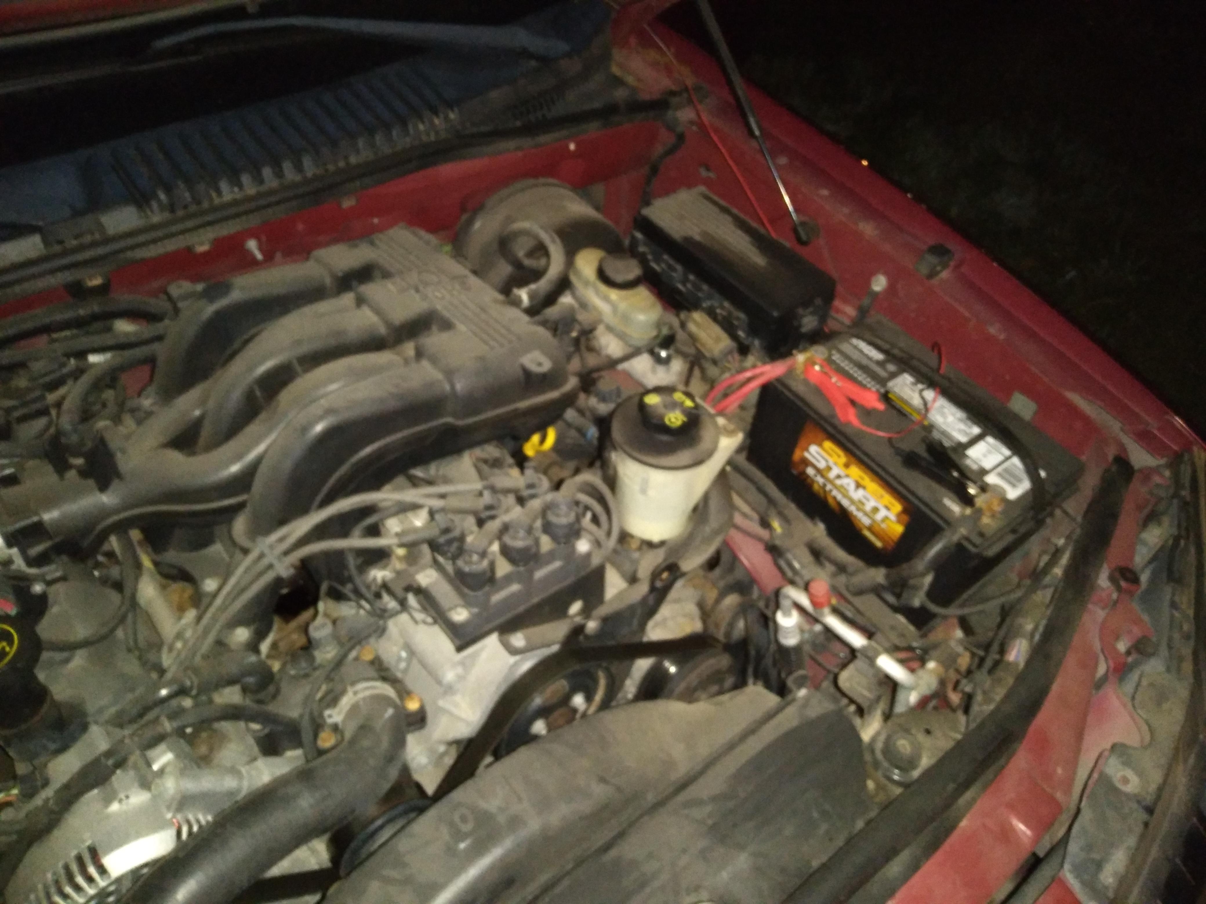

In just 5 days of short-commute driving, I noticed that the coolant level started from 75% of the way from the bottom line to the top line (closer to the top line) to instead all the way down to the bottom line. Both measurements were done on a cold engine.
I pressurized it to 15psi as shown in the included pictures and did not see any coolant coming out. There was already a wet spot as annotated in the picture below. The wet-spot did not seem to grow by pressurizing the reservoir. And, it held 15psi fine. Normally I would pressurize the radiator, NOT the reservoir, but this vehicle does not have a radiator cap. That is where my primary question lies -- am I even doing the pressure test right by pressurizing the reservoir ?
