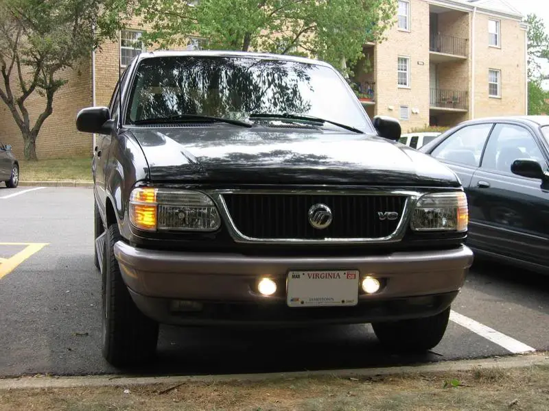

you'll get the look but not the function.. idk 'bout that looking retarded cuz its your work and your style so i dont have the right to judge that.. i've already shown you how i did mine and the look that i wanted to achieve.. maybe you can settle for the aesthetic part first till you're ready to fully mod it..

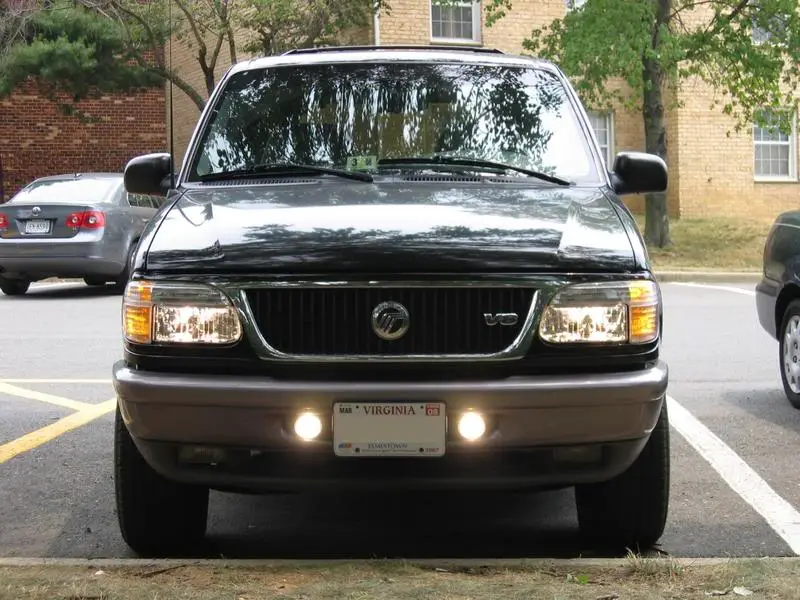

i think i know what you're trying to do and yes it is doable.. lets see if this will work for you..
1. the corner wiring doesnt need to be touched. it already works as a running light so let it be. just change the bulb to an amber one so it matches the one below it. $3 a pair at walmart or any auto store.
2. TOP: it already has a dual filament bulb in it. All you have to do is replace it with a clear bulb so it matches your headlight. cut off the "signal light wire" about 3-4 inches from the socket so you still have a lot of wire to work with. wrap the wire you just cut off with electrical tape. make sure it doesnt come in contact with the frame so it doesnt short out your signal lights because it is still active whenever you use your turn signal. Now extend the wire coming from the BULB SOCKET to your high beam wire. After doing this properly, the TOP lights will burn brighter whenever you use your high beams. It will also come on when you flash your high beams in the morning.
It'll work 'cause all these bulbs run on 12~14V but has different brightness due to their wattage ratings (i.e. high beams=12v/65W , turn signal bulb= 12v/5W[running light]-25W[turn signal light]).
try it out. worse thing you can do is pop a fuse.
You understood perfectly, the thing that was worrying me the most was blowing the bulb up... if you think about it.. that higher wattage part of the bulb is only lit for short periods of time.. blinking... Don't know how long it would last while I'm driving around outta town with my brights on.
But I'm gonna give it a try... seems I figured a way to do as I proposed, and even make the top part function even more with the headlight... the little corner.. I could care less about.
