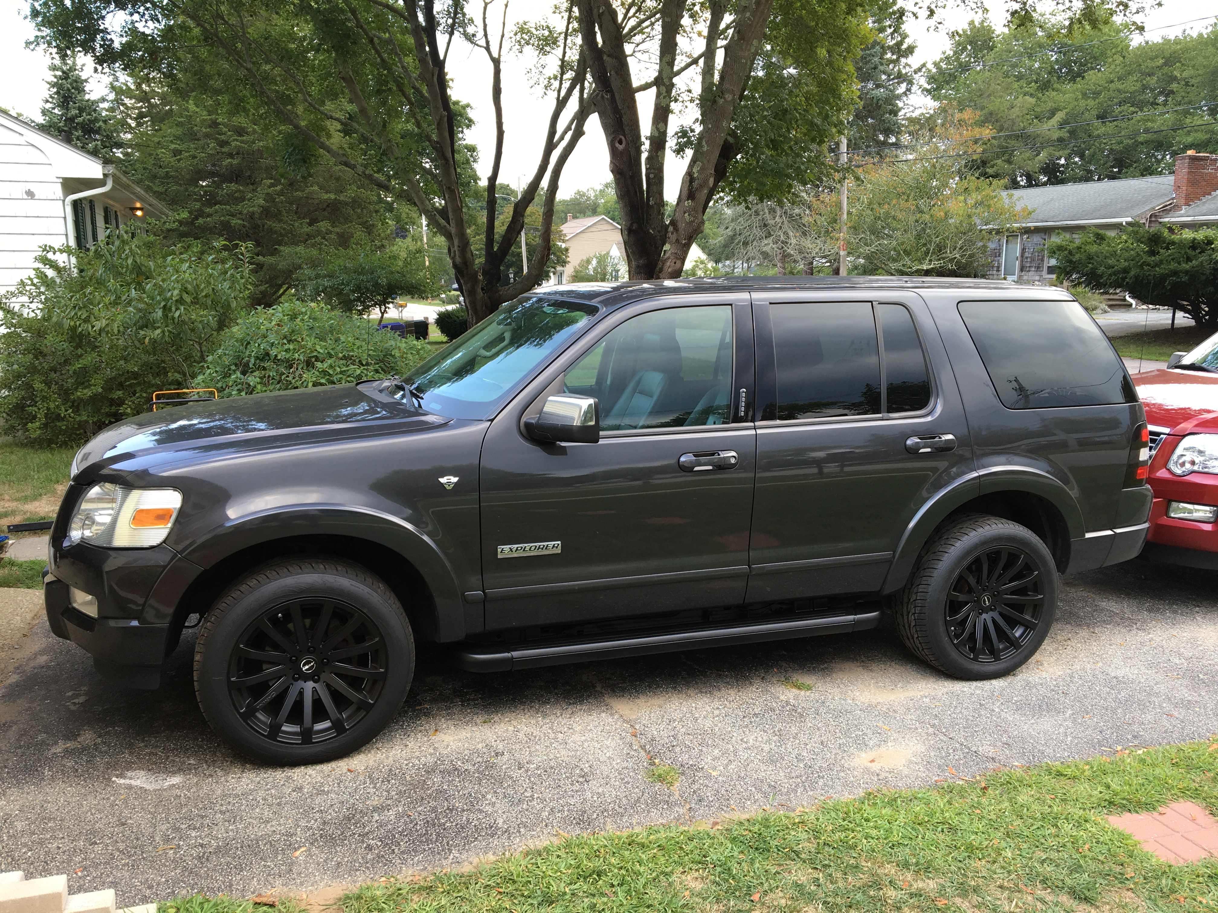

This is what I was running on my 4th gen...
19x9.5 et35mm offset front with 255/ 50R19
19x9.5 et30mm offset rear with 285/ 45R19
...no rubbing inside or out at stock ride height.
You don’t necessarily have to go that aggressive, but it looks pretty good!

With the tire size I was using, I could push them out another 5mm more than the front without it poking past the body.
