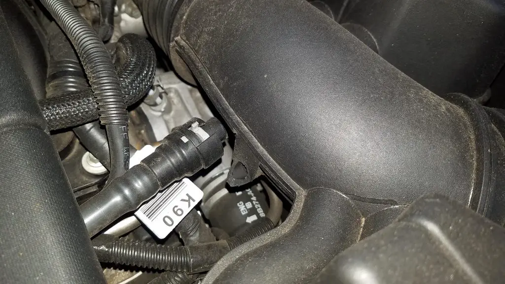

Tire shop noticed by crank case vent tube was snapped off the factory intake. Probably service from the previous owner who wasn't careful.
Is there any easy fix?
I’d try and find a plastic barbed fitting that was fairly snug, and epoxy it in.
Maybe you could find a replacement at the junk yard.
I have the piece that broke off, it's still in the rubber tube. Maybe I could epoxy that back on.
You can use a variable temp soldering iron/woodburner to sort of "weld" broken plastic parts together. I can't say if that plastic will melt okay, but it may be worth a try. If you can find a scrap piece of similar plastic, you can use it as a filler to strengthen your "weld". You can use a dremel or small file to lightly clean up your "weld" and make it more visually appealing.

I don't think so, I did start to get an error code eventually. That is why I replaced it.
