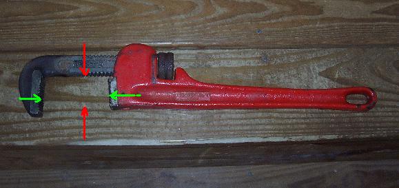

A pipe wrench may be a suitable alternative to using a strap wrench when tightening or loosening the crankshaft balancer bolt. A typical pipe wrench is shown in the photo below.
The span between the jaws as identified by the green arrows must be at least 4 inches. The depth of the jaws as identified by the red arrows must be greater than 2 inches or the damper will hit the rear of the upper jaw adjustable support and the jaws will not grap properly. My 14 inch wrench with a 4 inch span between jaws was not deep enough to use.

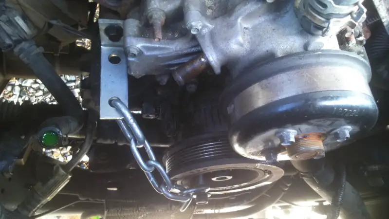

The jaws should be applied in the area of the balancer identified with the green arrows in the photo below. Avoid the area identified with the red arrows because of the indentations for the crankshaft position sensor. If these are damaged by the wrench the engine may not start or run properly. A bolt may be passed thru the end of the wrench and a chain. The other end of the chain may be bolted to the head to keep the wrench in position allowing one person to accomplish the task.

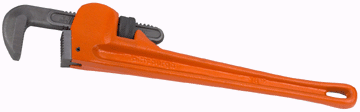

I have what looks to be that exact pipe wrench but it comes up just a fraction of an inch short, maybe I'll run to home depot and look for a bigger tooth bit thing.
I've tried everything but putting the transmission in gear (ouch!) and I'd pull the engine if I could but I've never done it before and don't have access to a lift. Should I just keep trying with the impact wrench? It's borrowed and I only have a small compressor so I'm limited to pretty intermittent use.
Can't torque it with an impact wrench
I had the same problem when I tried my 14 inch pipe wrench. An 18 inch pipe wrench may have a wider span range and be deeper. According to the Harbor Freight website an 18 inch steel wrench costs $9.

I know I'm resurrecting a REALLY old thread, but others will visit it. Just do this:
