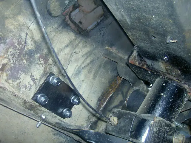

The pic is taken looking up to floor board, you might have to turn head to left HA HA. To the left is the plate that the roll cage is setting on. To the right is the frame that I have to connect tube frome plate to frame. Problem is I only have an 11" piece of tubing left and that is the shortest I can use. There are two different angles, so I have to get it right the first time. There are probably different ways to do this, but this has worked for me.

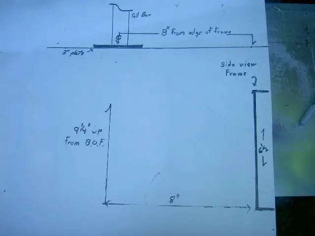

First I drew up a simple side view plan with all the info showing frame to the right and the plate to the left in relation to each other.
Next I laid tube on drawing so that both ends would intersect lines of the frame and plate. You can see that at its longest length that there is no room for error. And also that the top of the tube when cut will take up most of the 3" plate. Next I looked directly down and transfered the lines to the tubing. Square tubing would have been easier to mark then round.
