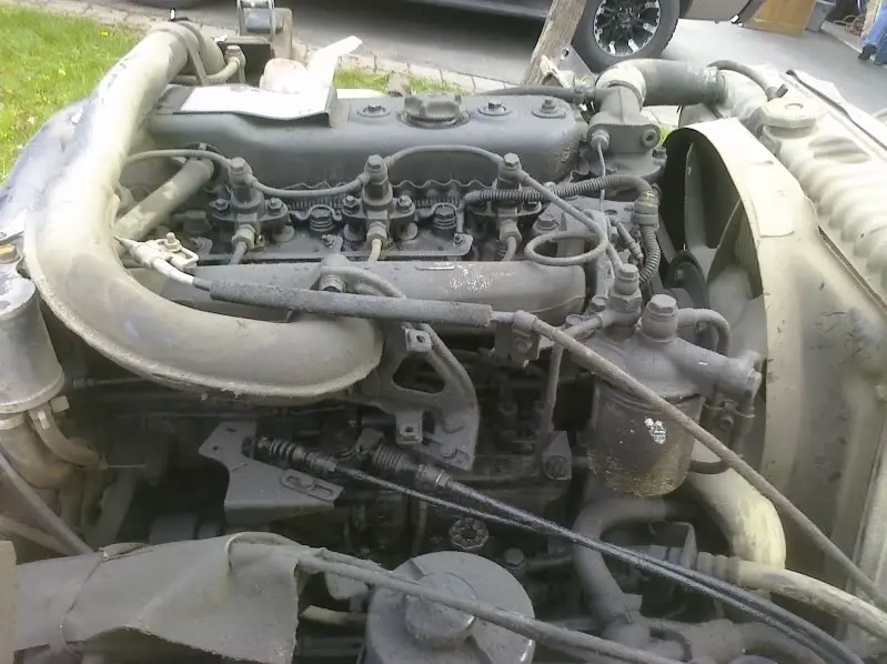

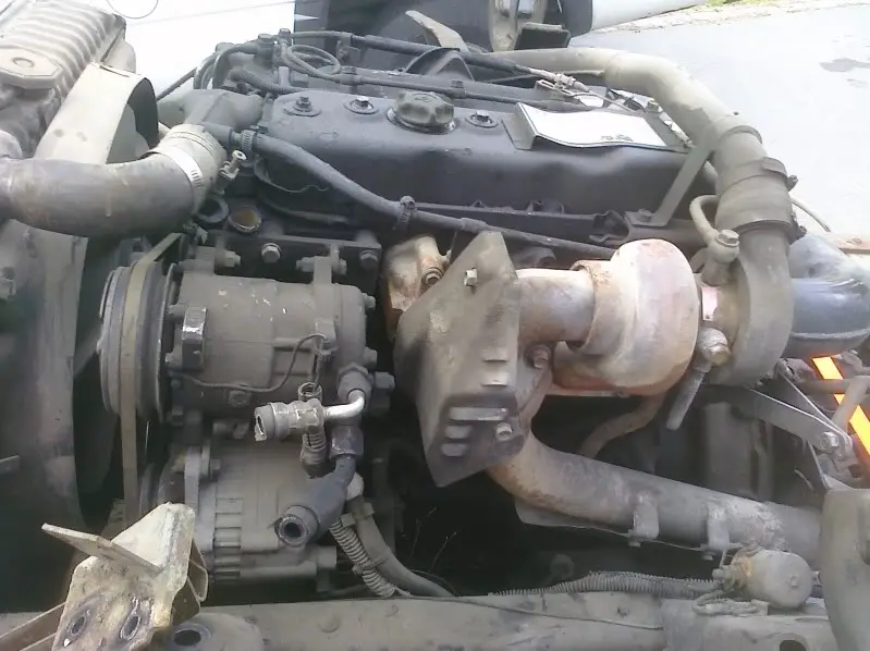

damccain
October 29, 2009
50
mount vernon illinois
99 eddie bauer
I had a chance to buy a 4bdt for a Guy for a grand and passed it up. He had it the same way yours was with the front frame section. He had a gas can and even startedit up for me and everything. Wish I would have jumped on it now LOL ill follow this build closely.
damarble
June 20, 2008
739
19
Washington
01 Sport Trac 5.0L manual
That's what I paid for mine and I think I got a steal.
