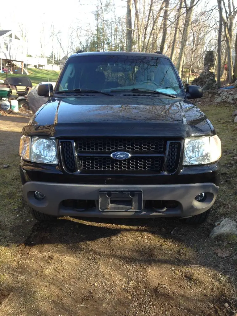

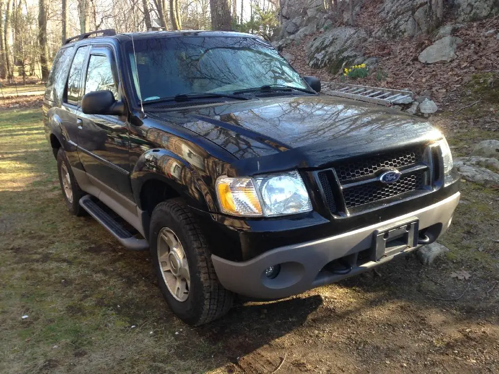

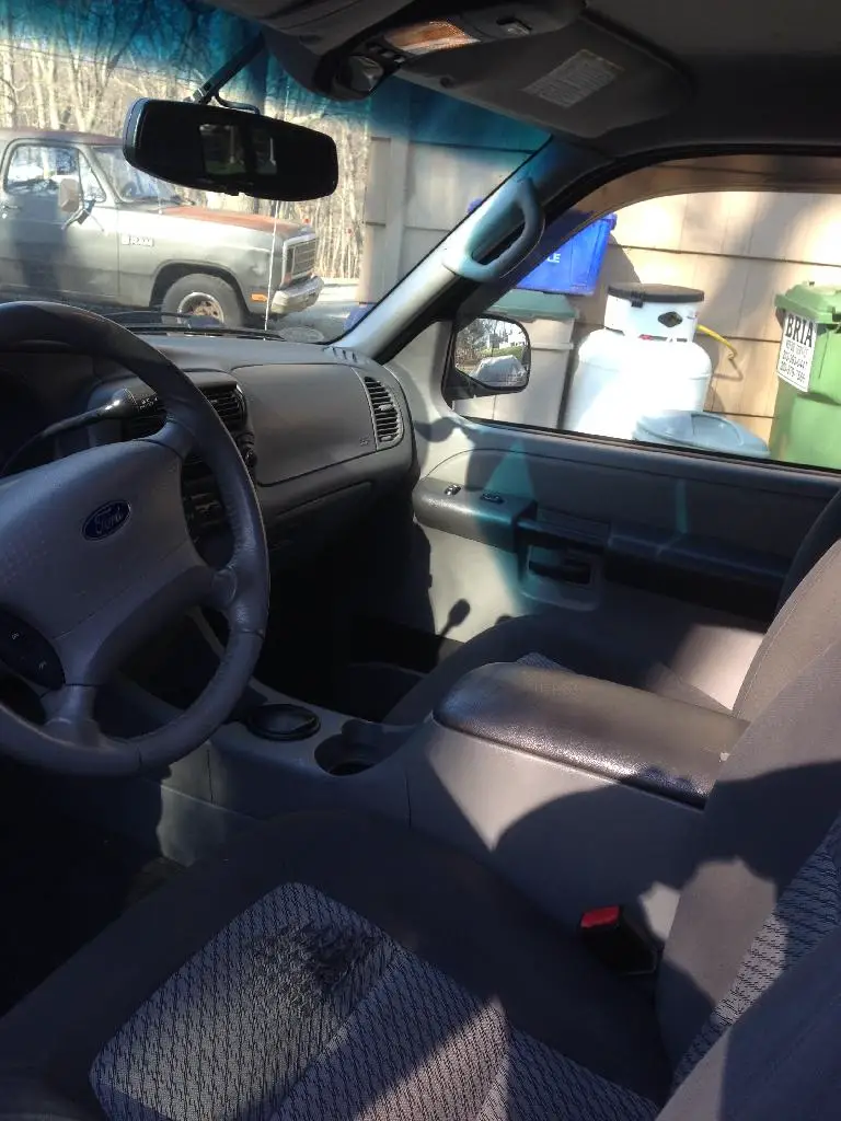

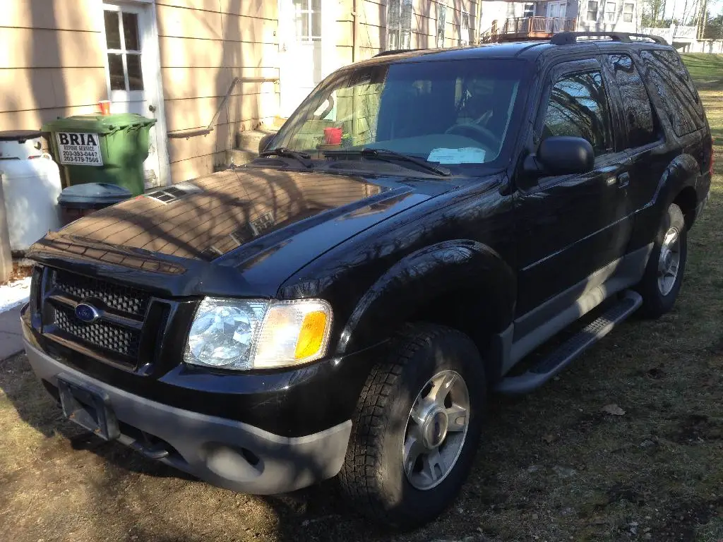

Just some photo's of the Sport. She's in great shape.
Wow that Sport is in great shape, wanna trade? :D
Didn't get much done today due to me being one of the last Mohicans in Connecticut to catch the dam flu. Swshawii thanks for compliment and info and I'm getting the code reader tomorrow. DTC's are a great place to start.
Mustang6878 the good old fashion compression test sounds great too and I will do the compression test. If all else fails and I do need another engine, I'll be sure the replacement has a compression test done first before I buy it. I only wish enough strength to do just one possible engine swap :)
Mitch if you were a lot closer, I'll just might consider that swap because the Sport Trac is my first choice :) The '01-'03 Sport model really reminds me big time of the 1st gen Sport Tracs.
