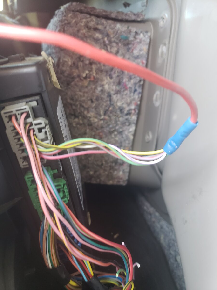

Ok, I have read through almost everything here on it, I am having a strange issue.
I have lubed all the switches and checked what wires I could on my 03 XLT. Where I am stumped, i have checked continuity at the grey plug to the CSM for the wires going to the door locks, All are showing as working there, however only the drivers door will chime with the ignition on I replaced the CSM with one from a wrecking yard with the same result. even the keyless entry keypad works on both. What am I missing? Only thing I can think of is the wiring out of the CSM is damaged somewhere, But I dont know which of the three plugs to start with on the CSM, and where they go to check continuity.
UPDATE, Since I have been unable to find the issue, and to keep my Battery from draining, I removed the puddle light bulbs (you have to remove the mirrors) The middle light bulb in the rear map light, and pulled the console and snipped the BLK/ LT BLU wire at the plug for the map lights. You dont get a light to come on opening a door, but you do retain map lights this way.
Final update, after thinking about this a while, I decided to just pigtail all of them to a ground at the CSM. I could have left the drivers door to work, but since I hunt, I like to open my door and slip out without lights and chimes going off. Permanent fix, no more damn light. Picture of fix:

After a long time with door ajar issues, when they were securely closed, I pigtailed the wires for the sensors (except driver door).
Problem, or no-problem, solved. Too much nonsense with today's vehicles.

This might end up as my fix as well, just do it at the plug into the CSM, to eliminate any corrosion issues between the door and there
See update in original post :)
