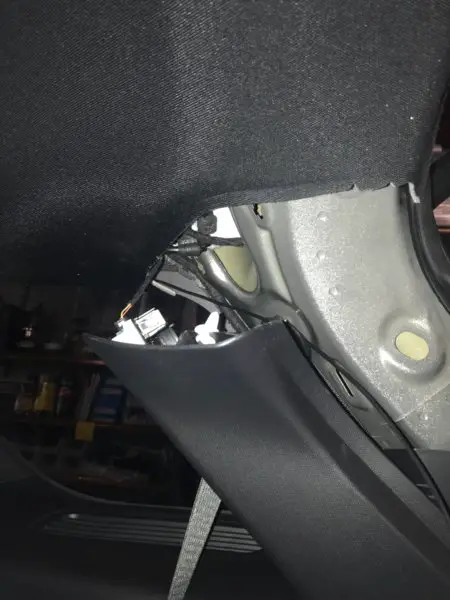

  3. Split off the two cables at the front/right pillar:
    1. Ran the power cable down the pillar using the Blackvue plastic wedge tool.
      1. Fed power cable into top of glove compartment. To get more room to work behind the glove compartment, press in the tabs on either side of the inside of the glove compartment to release it to fall forward another few inches, which provides me enough room to work without fully removing it.

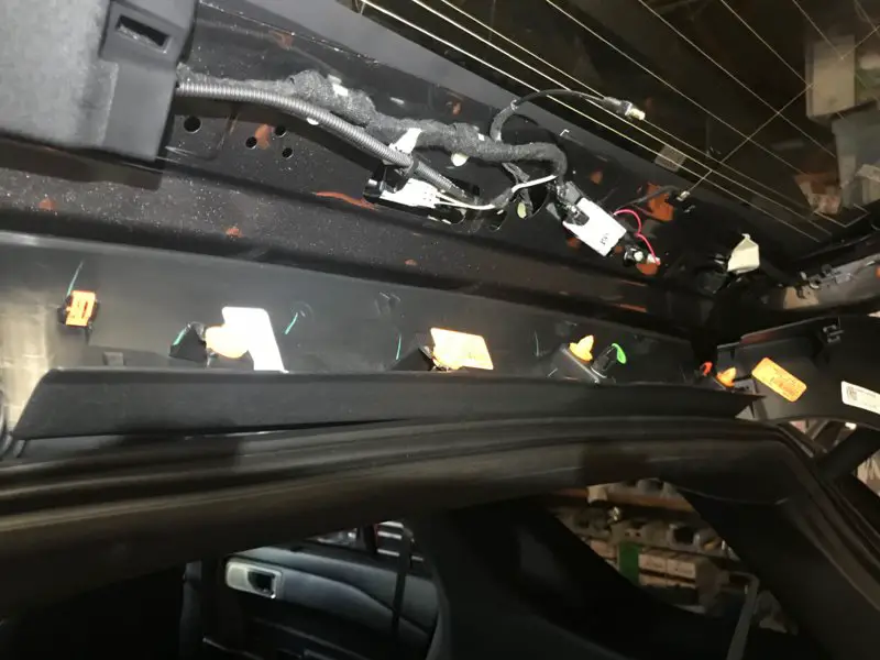

    2. Ran the rear camera cable across right side under headliner to the rear lift gate.

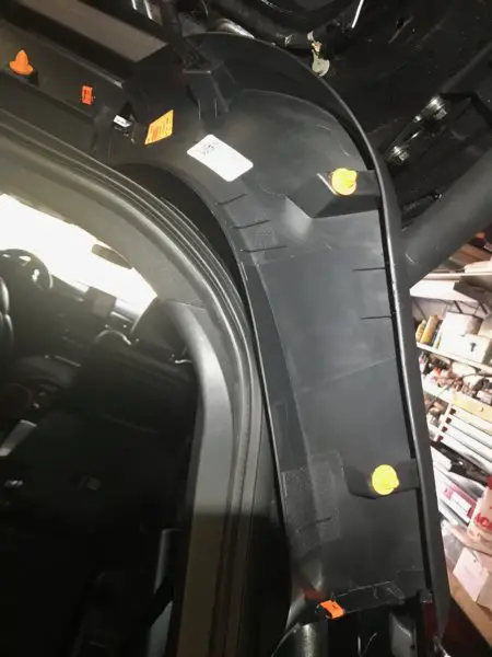

      1. In order to help run the rear camera cable into the lift gate's cable boot properly, I removed some paneling around the lift gate. The pics show were the clips are located to help you know where to pry safely.

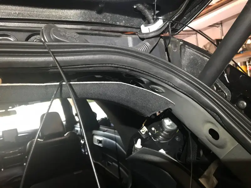

      2. I partially removed the inside right panel with the speaker to get access into the headliner to run the cable to the rear access space of the boot.

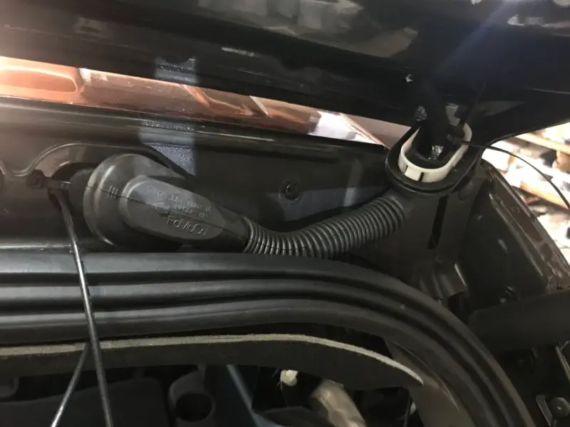

      3. The boot can be removed by pressing in at least two adjacent points on the boot that are marked with parallel lines. I chose to use plastic wedge tools from my trim removal kit. I pried under the boot to press the tabs firmly enough to release, simultaneously was best, but possible to do one tab at a time if you can prevent it from slipping back in and locking again. Once loose, the boot can be pulled out some, and then repeat with the other boot.
      4. I ran the power cable above the headliner and into the space behind the boot and out the boot hole.

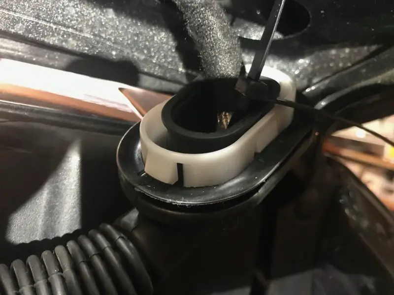

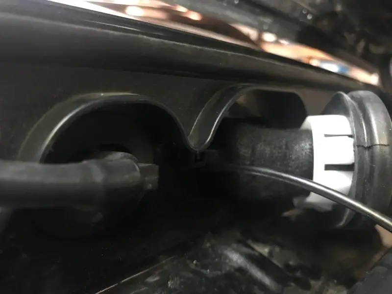

      5. Pinch the graffers tape on the inside of the boot (white plastic is around it) to find a spot that has the most space without cables where you will run the cable through. I used wire cutters to make some small snips in the tape and boot rubber behind it, large enough for the power cable to run through.
      6. To run the cable, i used two long (~20") twist ties, fed one through my new hole, worked it through the boot and out the other side, then connecting the other to that end where I want the cable to end up coming through. This helped me get a good grip when pulling the cable through my small hole and when it gets snagged in the boot.
      7. I laid the cable on the end of the twist tie lock and wrapped with electrical tape, making sure the end of the cable was wrapped to prevent snagging while it's pulled through the boot.
      8. I pulled it through, working it around snags and out the other end, removed the tape and knew I got through the hardest part! SWEETNESS!
      9. Ran the cable through the tail gate to the top/center, wrapped the cable with graffers tape where it exited to the window in order to protect it against the metal edges.
