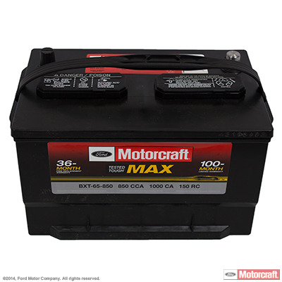

When it is time to replace get the Motorcraft BXT65-850 from OReilly or Ford Dealer (sometimes the dealer is cheaper than OReilly). The 100 month pro-rated warranty really comes in handy. Mine died about 3.2 years in, just after the 36 month free replacment warranty expired but the 100 month pro-rated warranty brought the replacement price down by $100.
