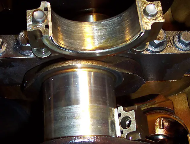

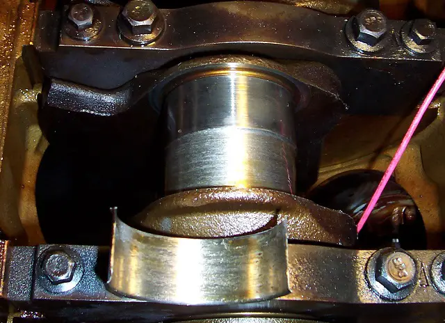

In my opinion the 4.6L has a tendency to spin rod bearings.
But bad rod bearings shouldn't prevent the crankshaft from rotating.
depends how bad. my brother managed to weld the bearings to the crank on my parents' dodge 5.9...
