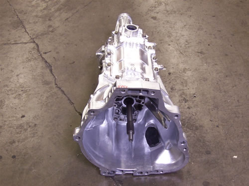

this is a 4.0 bellhousing http://m5r1.com/im/pictures/1515/1515F.jpg
hopes this helps

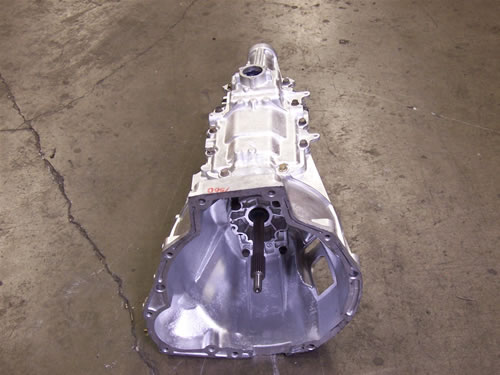

the 2,3 litter has the starter on the oposit sidehttp://m5r1.com/im/pictures/1500/1500F.jpg
4.0L
2.3L
correct 1
that is the correct 1 that i have so u think that i could repair the 4.0l that i have in my explorer with that 1 from the puulapart that came out of a 3.0l
