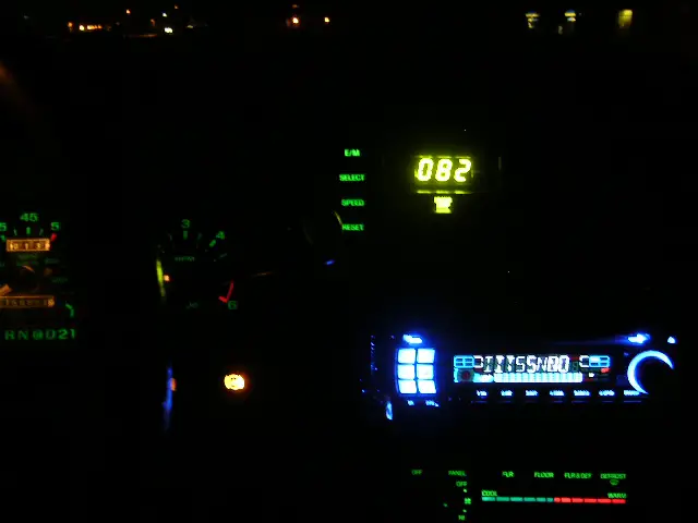

Well, Here's a couple of pics of my project. Not the dash, but its digital :D
That message center is sweet. Outta curiosity why does it look like it's built for the passenger to operate it?
well its designed to fit in a center console out of a second gen which would angle it towards the driver. Mine is just sitting on the transmission tunnel at the moment
