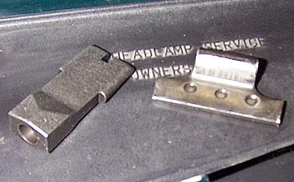

This picture is from Steve VB's photo gallery:
You will know if you have a broken band if you find the piece on the right. That part is the lip of the band where the apply strut engages. The piece on the left is the part the adjusting stud pushes in, and out against the lip of the band. The part that you found is on the opposite side of the band (passenger's side of the transmission).

I pulled the VB (Gasket looked perfect on it). Saw the two adjusting bolts. The one on the front (towards the front of the explorer) of the transmission looks good. The adjusting bolt on the back is there, however nothing is attached to to it, (it's just sitting there).
I found out why I found the part of the left, (see BrooklynBay's reply above), was sitting in my transmission oil pan. It appears that a piece of the lip of the band is broken off, (see part on the right in BrooklynBay's reply above). Most of the band lip is still in tact, however part is broken off, (where it the apply strut actually engages the lip).

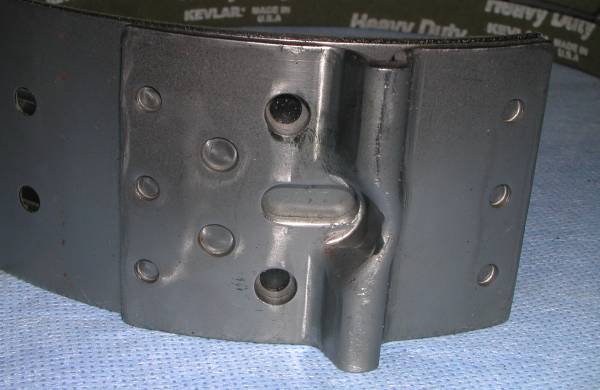

I got these pictures from Glacier991's gallery:
Thanks Glacier!
I noticed after removing the VB that there was another piece above it that has the VB "looking" pathways. I believe I would need to remove this to replace the band. Do I need to remove this second "VB-type" piece and how do I do it?
Unfortunately, there is no simple way of replacing a broken band without opening up the entire transmission. I would suggest that you rebuild it at the same time since you will have to dismantle everything to get to it anyway.
BB is correct. The intermediate band will require removal of the transmission and disassemmbly back past the center support... that far in - rebuild it. If had been the OD band, you might have done it on the cheap.... but I agree with BB on this one, rebuild it.
By the way the band pics you found in my gallery were of a 4R70W band...but matters not as it is very similar to a A4LD or 5R55 band
