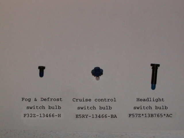

The light bulb part for the fog lamp light bulb is F32Z-13466-H for '98 and up. It will work in '95-'97 also, but the bulb is a bit more blue than the original green ones. It works in both the fog switch and defrost switch.
Trying to replace the bulbs in my fog lamp and defrost switch...
Just called my dealership.... they don't have them in stock, but can get them. Unfortunately they only come in packs of 10, and if they order a pack, I'm on the hook for $54.00!! Anyone else need some? I'm not about to pay $54 for a bunch of bulbs I'll never use when I can get a whole switch for $30!
Nuts!
-Joe
edit: Found them through Torrie at www.fastpartsnetwork.com. Torrie comes through again!
Still waiting to hear back about the headlamp switch bulb though.... the bulb is $32, but the whole switch sells for $26.... That's crazy! F--'in Ford anyways LOL!!
-Joe
Just got a response from Torrie at FastPartsNetwork (formerly FordPartsNetwork). He told me that it's an error in the catalog. Apparently the correct price for the headlight switch bulbs is $7 each.
