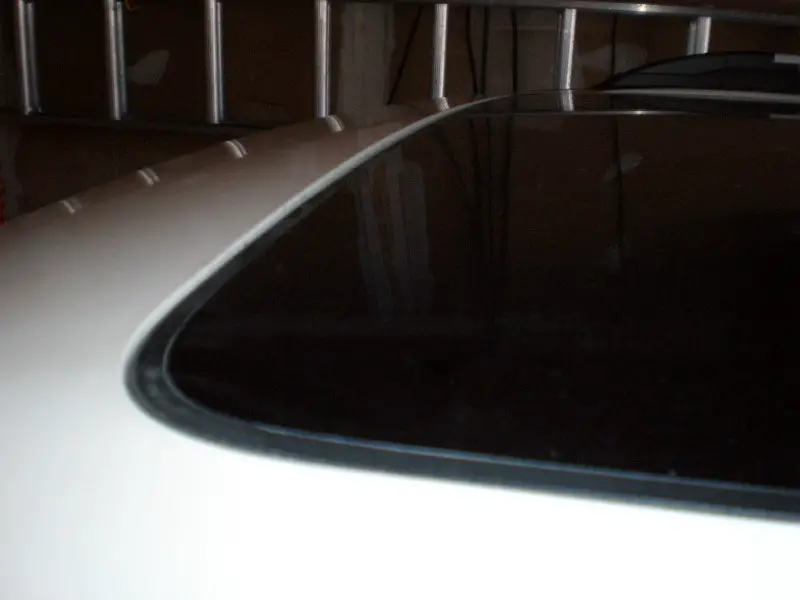

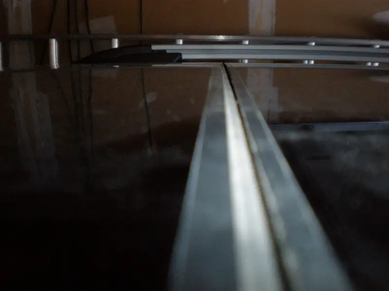

The opening (rear) part of the front panel is exactly level with the front edge of the larger moonroof panel (Pic #1 ). The front edge of the opening panel is level with the roof in both front corners. It is below the roof in the middle but that is due to the curvature of the roof (Pic #2 ). It is not a defect. The glass panel is flatter than the curved roof.
