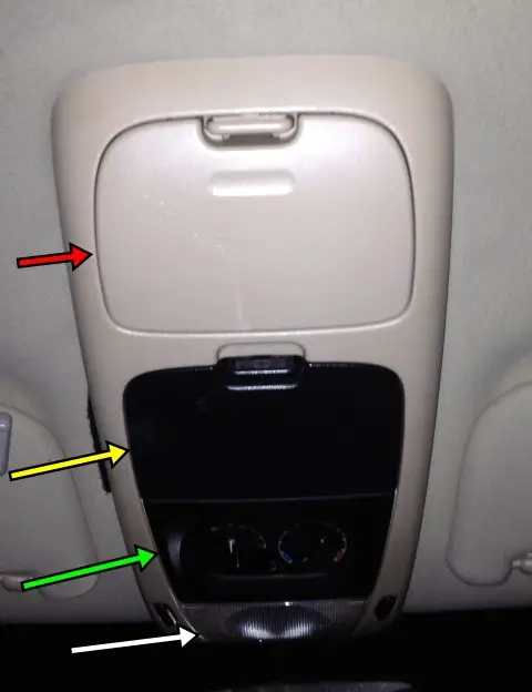

Here is my console.
  • Red arrow points to the Garage Door Opener Holder
  • Yellow arrow points to the Sunglasses Holder
  • Green arrow points to the Rear Climate Controls
  • White arrow points to the Front Dome Light

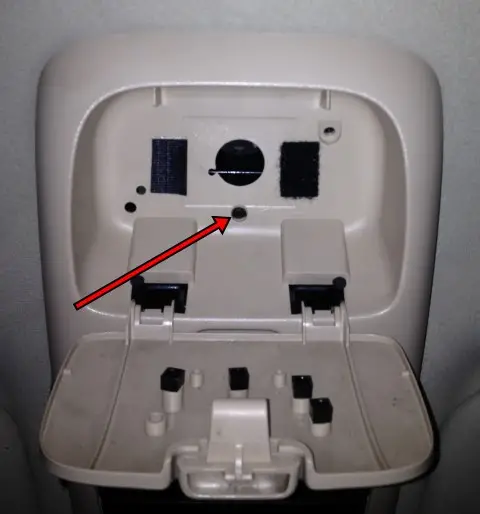

To remove the console: open the Garage Door Opener Holder and remove the screw indicated by the red arrow:

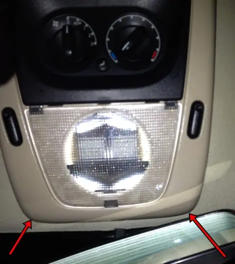

Then pull down on the front of the console at the points indicated by the red arrows:
