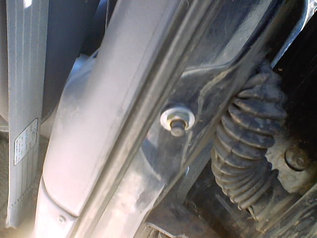

How do i disconnect the chime? Is there a wire to snip or sumthin. I have looked for the little button the pops out when the door is open, but i can't even find that....it is really annoying, i am sure you know what i am talkin about.
The button is in the middle of the pillar on all 4 doors. Its the only thing there, I dont know how you cant find it. If you want to just disconnect the chime, find it under your dash and pull it out, it just plugs into a socket.
the stock button looks like this minus the silver washer
