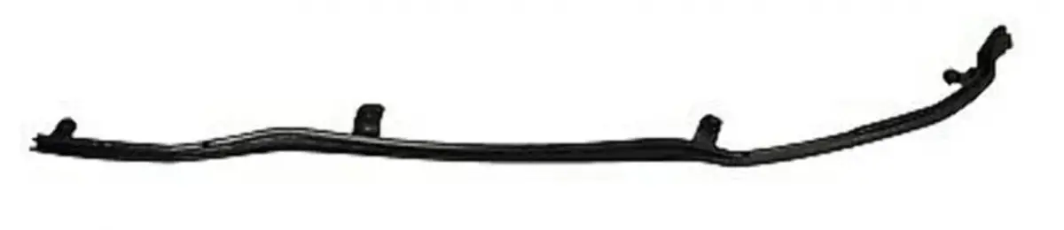

I'm reviving an old Post because I just did this repair.
Both doors edge weatherstip on my 2016 ExPlat were torn so I replaced them with Ford parts, the price is still expensive at $30+ each, shipped.
Using a body tool the tabs just pry/pop out, the new strip has new tabs that simply push back in, pretty easy, +/- 15 minutes.
Ford Door Weather Strip Part Number BB5Z7825325B & BB5Z7825324B
