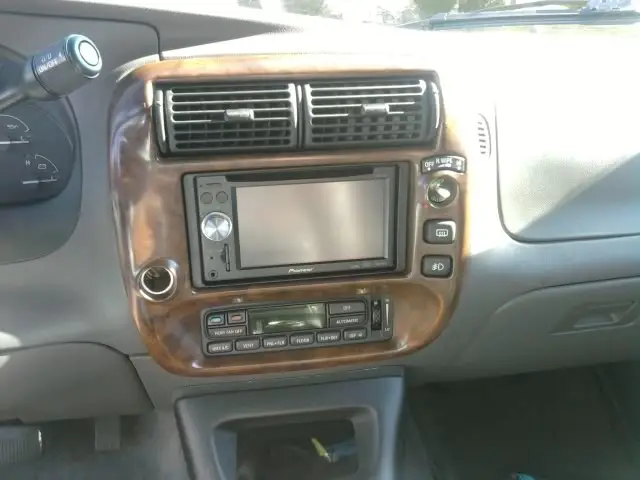

Thanks. I ended up just going with the Scosche that was at Wal Mart because I was anxious as hell to get the thing in. It looks great, I'll have pictures up pretty soon! I still have to run the bypass for the parking break cable.
post some pics of the double din I get mine in about two weeks. Did you go with the 6.5" or 7"?
Will do like I said I'm going to have to run the parking brake bypass today when I get off work then I'll post some pictures of everything together. By the way while we're on the subject. I have absolutely no idea what "parking brake cable" to wire this thing to. Wiring is absolutely beyond me and I feel like it's something simple but I can't figure it out.
Only other thing you need to know is you will need to trim the bezel. Nothing huge, I was worried about destroying my bezel, but it was nothing. All you have to do is trim the back top and bottom lips around the headunit opening flush with the rest of the bezel. If and when you test-fit the unit, you'll see what I mean.
Yeah the trimming was so minor you can't even tell. I'm really happy with it I just wish I didn't have to be at work so I could wrap everything up.
