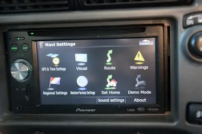

I put a f700bt?? in,
deck is really short, glued a block to the back of the rail to stop it from falling in/back.
deck is narrow but slightly taller, so I filed clearances to the top and bottom of the trim - this locates it left/right
Ends up fitting well, lots of room to play.
If I remember, this post will be updated tomorrow with pic.
easy install if you have a steady hand doing the filing.
adding GPS antenna location pic and without bezel pic

i have a pioneer d3 fit in my sport the trim kit for it i could only find on ebay under a ranger search. it fits great you have to trim your stock radio bezel with a dremel or mini grinder but i will put pics up soon to show it
