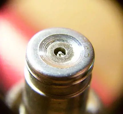

Not too bad for a first try:
Now to flow test and see how much anything changed.

My goal was to flow the modified injector before the weekend was over and I managed to pull it off. :)
One of the stock 19lb injectors did 195.5cc/min or ≈ 18.6lb/hr. Keep in mind that they have over 250,000mi and have never been cleaned. Spray pattern is sort of a four-sided hollow cone.
The modified one with no orifice plate blew 327cc/min or ≈31.1lb/hr. It also has a pencil-type spray pattern now.
Both were flowed at 3.0 bar.
