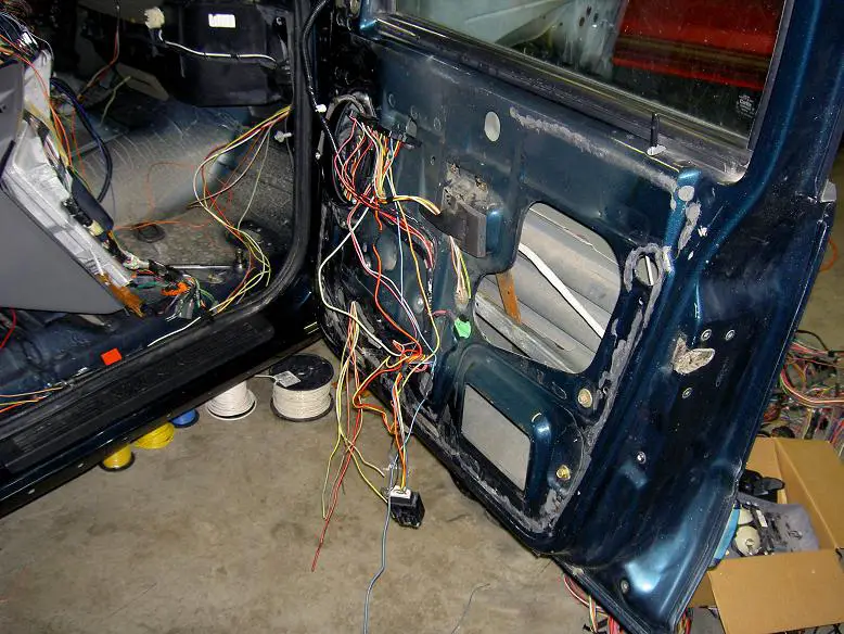

BTW, if you do need to change the actuator, two things; do not remove any rivets, stretch the holding bracket open(pry) to remove the actuator. Plus before starting that, pull the door panel, then remove the side glass adjustment bar.
That bar is directly in the path to reach the adjuster. With that out it is a much easier task. The one bolt that holds/adjusts that bar is about 2" from the latch side of the door edge, and about 6" from the bottom. With the bolt removed, the bar(guide for the glass) slips straight down. Watch the top as you remove it, it slips right back up very easily. To adjust that bar, which is the only glass adjustment, install it and the bolt(not tight), slide the bolt head towards the hinge side, and tighten the bolt. Good luck,
