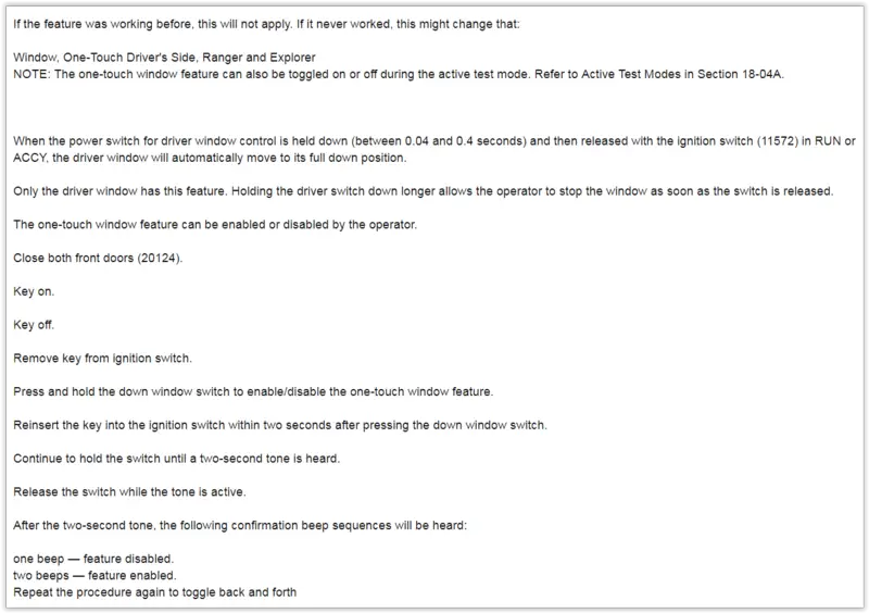

We ran across a thread detailing reprogramming the auto-up/down function last summer. We wanted to disable it due to issues with the flashing 4WD lights on the dash. I can't seem to locate it now. The search function on this site has always been disappointing to me. Maybe you'll have better luck. I found this generic answer. Perhaps it'll help in asking the right search function parameters.
How to Reset Automatic Windows | YourMechanic Advice
Good luck!
Team TARDIS
I found this screenshot from nearly two years ago. We didn't have any luck with it.

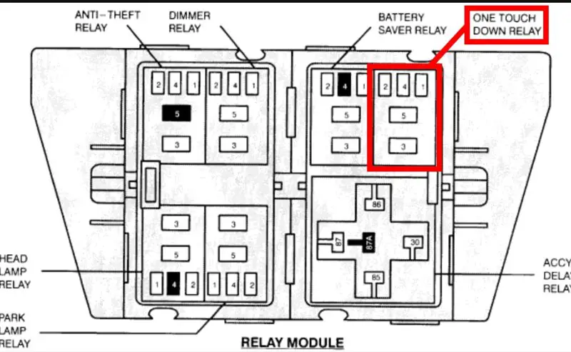

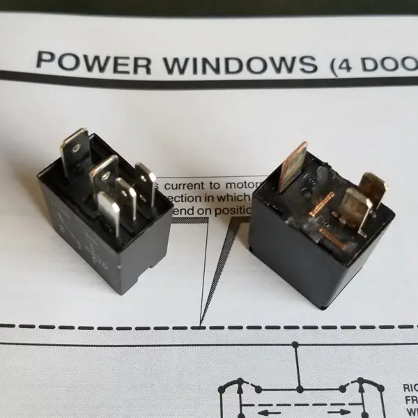

There's also a relay under the dash that controls the auto function. We defeated the auto function by modifying the relay but we lost the rear window defroster in the process. It cured our flashing 4WD lights which was what we wanted. If we pulled the relay the window lost all power. We removed two tabs to eliminate the auto function.
That's all we've got!
Good luck!
Team TARDIS
Thanks for the info on the auto down function! That might help me figure out what is wrong. My main concern was why the motor keeps running, and not stopping automatically, after the window reaches the top or the bottom if the button is being pushed.
