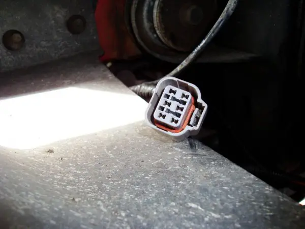

See Plug attached. (I am going to try and attach to the original post. I am not able to his. The option is not available for some reason.)
Attachments is turned off. I cannot show the connector for the DRL module. Dammm

# XL2T-15A270-AB
The plug has two rows of 3 pins each running horizontally. I appears to be black plastic, no heat sink, steel etc.

Ok, here is the pic sent from tripplec of the connector used for the drl module..

For those who may have been hunting for one or wondered the picture in the first link by sean99 is what it looks like. The one I picked up out of a regular Explorer had it mounted to another bracket and on the fender behind the power distribution box on the drivers side. But it was a different part number and did not work at all.
