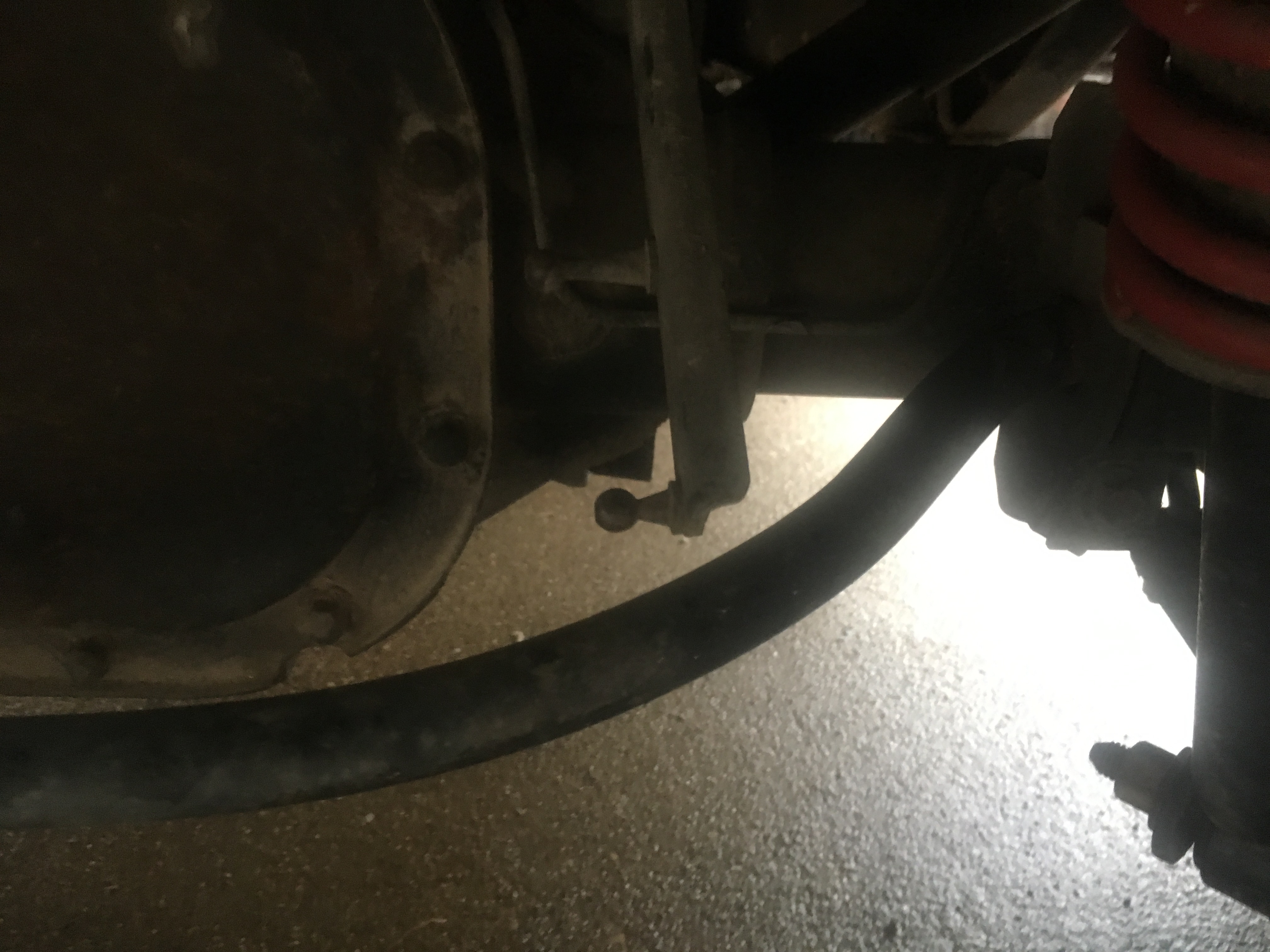

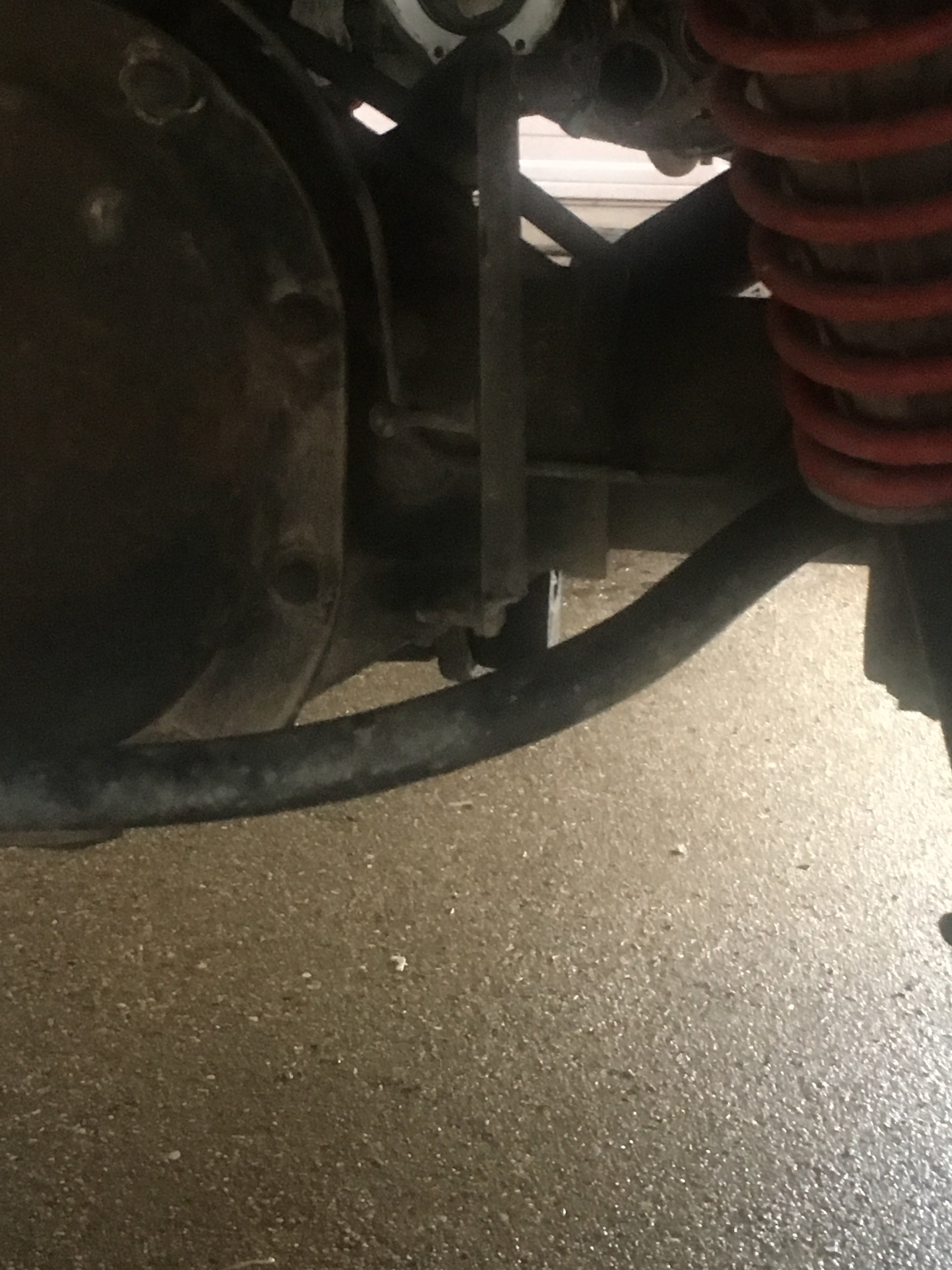

I think I do have the bracket on the rear end but I took the sensor off.
If you get a chance, check out that bracket. The weak link is the ball joint on the ends of that, corrosion eats them away. Mine on my 99 I saved, they looked ugly but weren't worn much at all. It's tough to get under there and lubricate those with anti-seize regularly. If your look usable, I could use them as a spare.
I will check it out when I get home. I was just under there this weekend looking for stuff to clean up from the old lines and that was one of them. IIRC it was in pretty perfect shape.
My phone doesn’t take very good picture. Plus it’s raining and I melt.
That looks good, I think there are two "arms" that connect to the diff, and the body, with the sensor on one etc. It's been ages since I looked at mine also.
