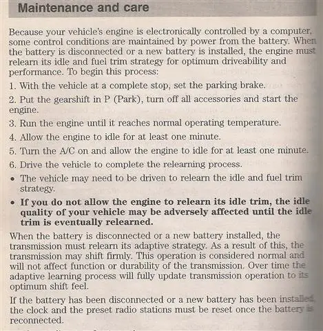

I don't know if this is the issue or not but according to the owners manual if the battery is disconnected, you must follow a procedure so that the computer can re-learn things. I will post up more info when I get home.

you probably cleared the kam memory and iac position learned values.
i would say do a nice drive on a hwy around 50-55mph for 5-10 min and about 15min or so in traffic.
From my owner's manual:
Thanks so much man! I was really scared when I started it up and it stalled over and over. Thought my tranny was shot!
I will have to disconnect the battery again and do exactly as the manual says. I plan on installing the fogs fully on saturday so will have to do it then.
