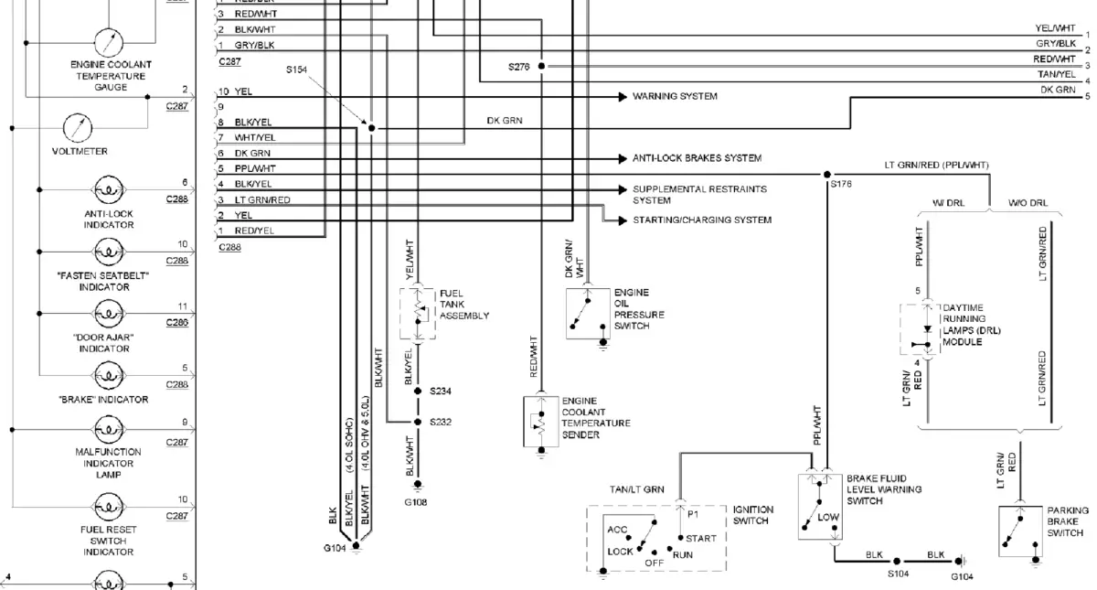

Okay.....so I looked around up there, not able to see much other than a wired tab with a single green wire (assuming some ground) ....so took cell video blindly moving cell/camera up and around tight crevices.....then photographed this off video which clearly is the "SWITCH" ...correct?
Would the thickness / thiness of e-brake pads "transfer" down through the entire cable setup / mechanisms affecting how far the pedal (switch) is allowed to be depressed?? Thin, worn pads allowing pedal to go down further than usual ...? My inquiry, theory here is being the bads got/wore all the way down thus allowing the pedal to depress futher, which in turn pushed down harder on switch/ damaging or taxing it to such a degree it will not "read" the pedal where it "now" stops on new pads. I'm I 100% off on this ?? Factoring everthing in it seems plausable. Second question...do I need to remove / or loosen up the cable / pedal mechanism to replace this switch or can I work it up in there with most/all of setup intact ?
On the other side of that switch is the contact. It’s a little like washer. Clean underneath it. Sandpaper nail file thing (ask your girl) works well. Brake off opens circuit, brake on closes it. This corrodes slightly and light doesn’t come on
Just replace the brake light switch. Its $20! The hardest part of the replacement is disconnecting the cable connector. I used two vise grips, one on each cable end and hit the connector with my air hammer. Cable came free. I'm in the rust belt. Unbolt the brake light switch and remove the cable. Install new part your done.
Is the replacement any better? Because that "switch" is a joke - just a silly metal-to-metal contact with a tiny spring, all exposed - worth about 25 cents . A bit of unavoidable corrosion, and it stops working. I routinely clean this thing with sandpaper every couple years.
I never thought about why it fails. I just assumed it was a bad design. When you push down on the petal the stem releases and the switch closes. The parts counter guy, told me they commonly fail. I just replaced the switch. Haven't had a problem.
It's not a bad design, it's called "designed by bean counters." They forced the engineers to design a switch that doesn't cost more than 25 cents to make. Guess that switch is not considered a critical part, but nevertheless cost many people a lot of money when they drove without noticing that the e-brake was engaged and wore the pads. Most modern vehicles have electric e-brakes, so there is no pedal and no switch. Problem solved.
