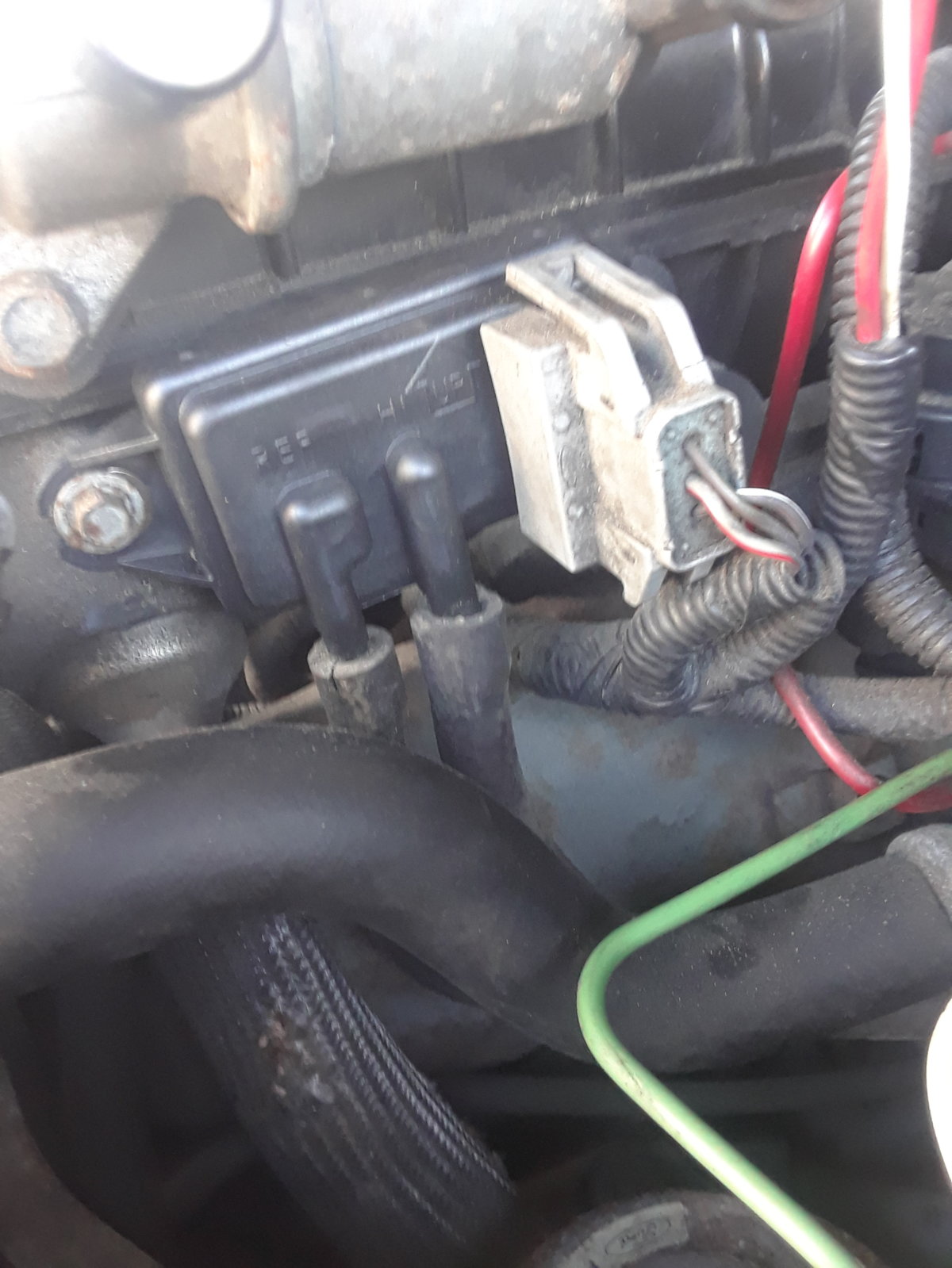

Pic is of the new dpfe sensor
you found a dpfe with an older socket style? there were some :) otherwise you had to hack a connector off the newer type or god what I see here is of course a older type plug on a newer type dpfe :/ ….. first message I got off the paper clip after a head job was dpfe out of range lots of smoke and chemical …. I tried another one still have a check engine light even though the smoke is clearing ….. going to try the newer style one tomorrow I had it on before I started having engine trouble …. not quite up to speed yet but there is an engine at least now ….after the pieces ...the things that prompt you to get engine work done are still there when you get engine work done
