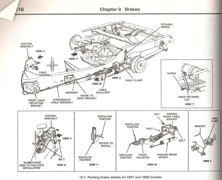

I need help figurin out how to replace my e. brake cable from my pedal to wherever it goesThe one along the frame seems ok but pedal just flops down any help wouild be great
This is from the Haynes manual - try to borrow or steal one;)
that retainer spring is there but it's attatched to nothing mabey thsat id it
