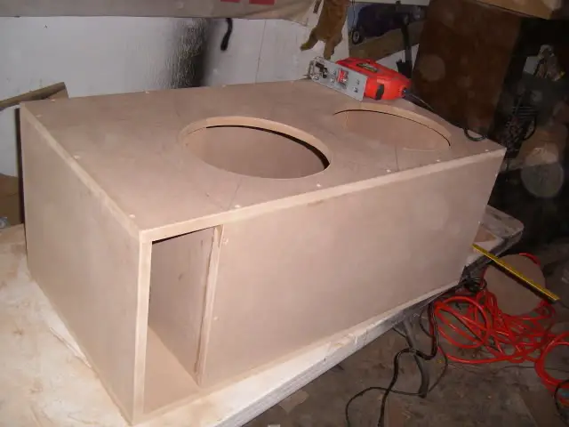

built this enclosure for a customer, he wanted it 100% bare, no carpet, no terminals of any kind, so thats what he recieved

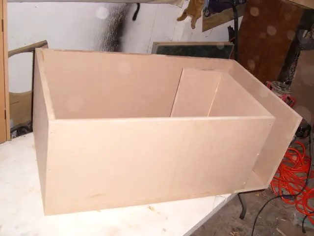

enclosure is 4.3ft^3 tuned to 35hz with 56 inches of port area.

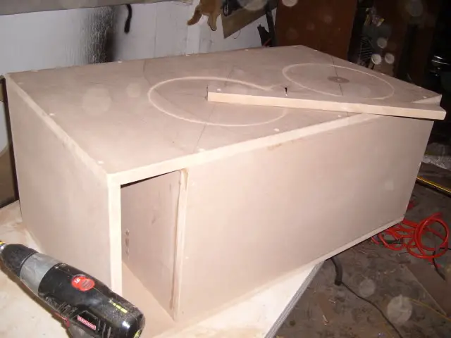

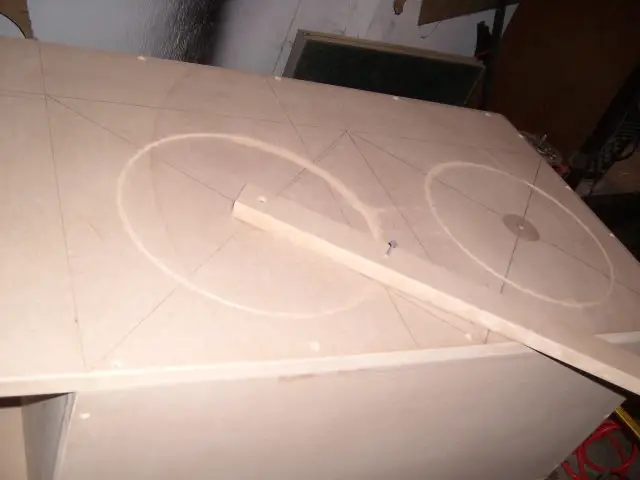

my router took a crap on me, so i had to cut the holes with a jigsaw, Mcgyver'ed up a circle maker and scratched the circles deep with a screw, when doing this, the jigsaw blade naturally follows the groove made (with very little help)

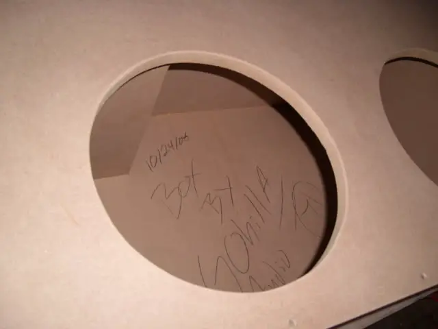

the cut is a little rough and not perfect, but close enough for the buyer
i love my oldschool rockwell tablesaw, never have a bad cut with this thing.
all done
