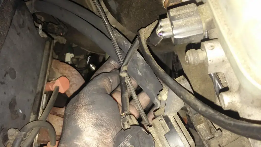

I did notice something else that bothers me and may be a contributing factor. The hoses going to the EVAP Purge Valve are starting to crumble apart, i can rub them and its like layers coming off, im sure with little effort I can scratch through them.
Most of the black on my hands is actually from the EVAP hoses. You canmot see any markings any more on the lines.
So I removed the IAC and replaced it with a new one from O'REILLY Auto for 33 bucks, new gasket and all. Cleaned the harness contacts with some electrical cleaner. The old one had a nice layer of build up on it, I cleaned out the intake holes with carb cleaner and wipes them out.
Thats dry rot. They'll be ok until you disturb them. That kind of hose is cheap enough to just figure out what sizes and lengths you need, and then help yourself to some new hoses. While you're doing that, you'll acquire intimate knowledge of your engine vacuum controls.
