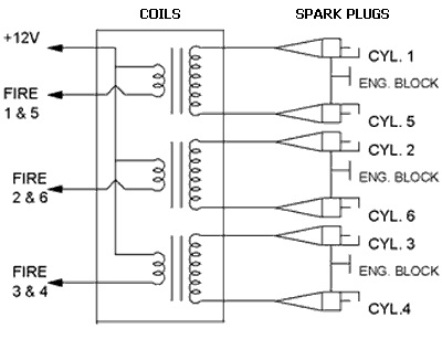

The crankshaft position sensor "tells" the PCM when the engine is rotating. If your scanner read the cranking engine speed (around 300 rpm) then that means the crankshaft position sensor is functional. Make sure the spark plug wires are tightly seated on the coilpack connectors. The ignition coilpack gets power from Fuse 19 (25 amps) in the central junction box next to the driver side A pillar.
If the fuse is good then disconnect the connector to the coilpack and measure the voltage from the pin in the connector to the red/light green wire and ground with the ignition switch on. It should be battery voltage. There is no ground wire for the coilpack so if battery voltage is present remove the coilpack mounting bolts and clean the underside of the bolt heads and the mating surface on the coilpack, the bottom of coilpack and then reinstall.
Sometimes the radio noise suppression capacitor fails in a shorted mode so if the fuse is blown disconnect the electrical connection to the radio noise suppression capacitor, replace Fuse 19 and then check for battery voltage to the coilpack.
If there is battery voltage to the coilpack, the grounding/mounting bolts are clean and there is still no spark to any of the plugs (there are three coils in the coilpack and only one may fail) then check the PCM main connector. It should be snug (do not overtighten).
The Explorer uses a waste spark ignition system. The spark plugs are paired and each section of the coilpack fires a pair of cylinders (one on the exhaust stroke while the other is on the compression stroke). The pairs are 1&5, 2&6, 3&4. The PCM "grounds" one side of each coilpack primary winding allowing an electromagnetic field to build in the coil section.
A pair of plugs are fired when the PCM interrupts the current flow causing the electromagnetic field to collapse inducing a high voltage pulse in the coilpack secondary winding. If a pair of plugs are not getting spark then either that section of the coilpack has failed or the PCM to coilpack electrical connection has failed.
