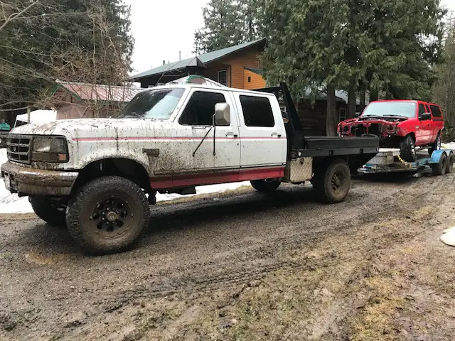

Flatbed is the only way to go
Factory bed so much wasted
Space just for cosmetic reasons
Once you go flatbed you never go back
Here is my shop truck / one of my babies, doing what she does best… hauling rangers and ranger based vehicles
Nice OBS Ford. What is wrong with the Ranger's front tire?
A lot of house to heat in the ID winter!
That red ranger was rolled low mile 2007 I parted it out kept the seats used the engine a trans to put another truck back on the road
