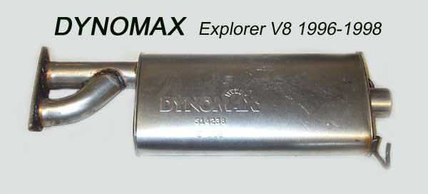

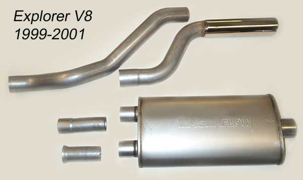

It would not be a bolt on. These systems are different. The main difference is how the muffler connects at the front. The 96-98 has a flange and the 99 has two seperate pipes. It could be done, but it would require cutting and welding. If you give me a little time, I will get you a picture.

Here are the pictures you are looking for. Let me know if you have any questions.

We once carried the X-Spec exhaust with a 3" pipe and a Magnaflow Muffler. This was a sweet system and had part numbers for all years. But Magnaflow discontinued the program!
I have one of the above kits for 99-01. We now only have the Dynomax System with the Superturbo Muffer. It has a 2.25" pipe. It does offer good performance with a tone you can live with. Not the same performance as the X-Spec system, but is still available.
John V @ EE

Hey Big Poppa
Is that what you were looking for? Got Questions?
John V @ EE
