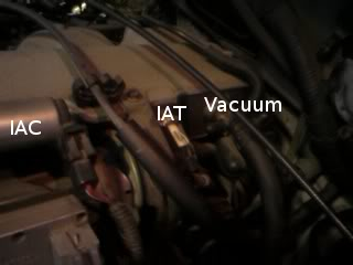

Intake Air Temp. and Coolant Temp. Sensor. The IAT is that thing clipped to the airbox, it has two vacuum lines connected outside the airbox, inside the airbox there is nothing connected to the vacuum ports and the CTS is on the front of engine, left of throttle body with an electrical connector, 2 pins I think.
Its not on the airbox....that's the bimetal sensor.
Here's the correct location
Try not to break one of the clips like I did.
Mine was covered in gunk, so I cleaned it off with CRC cleaner...
