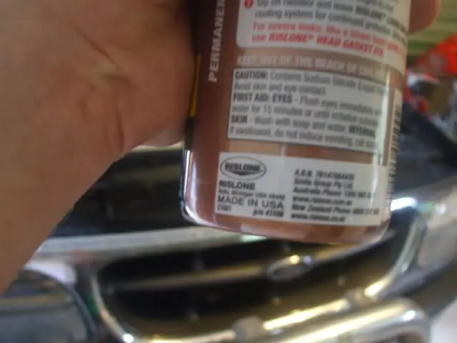

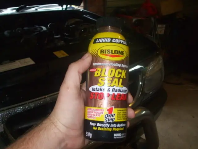

I swear by this stuff, it works great. It works in ethylene glycol coolant too.
And as always, made in the USA.
I will give it a try
I tried the stuff and it works great. No leaks and no steam. Thanks alot
