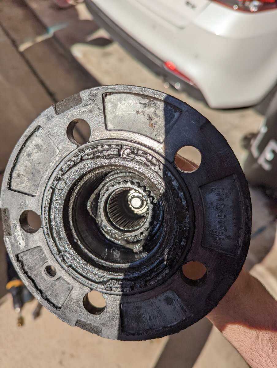

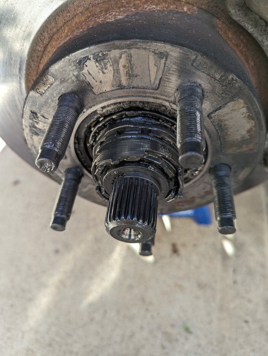

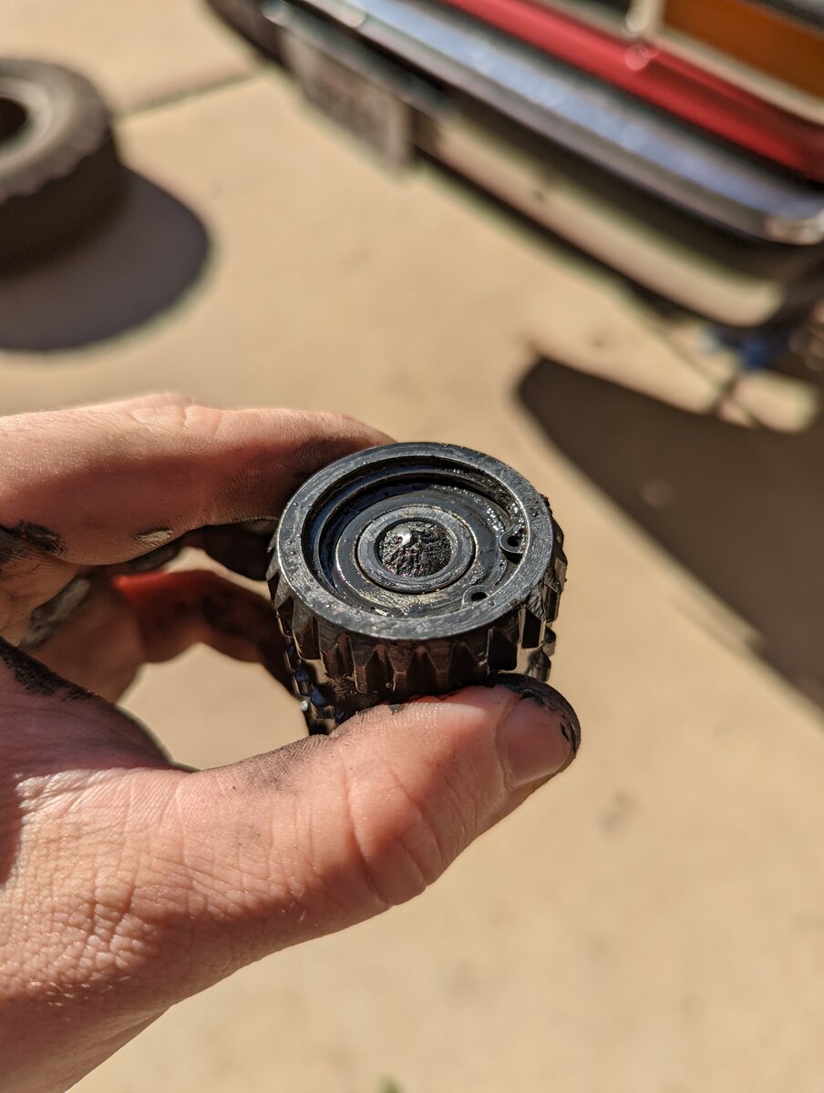

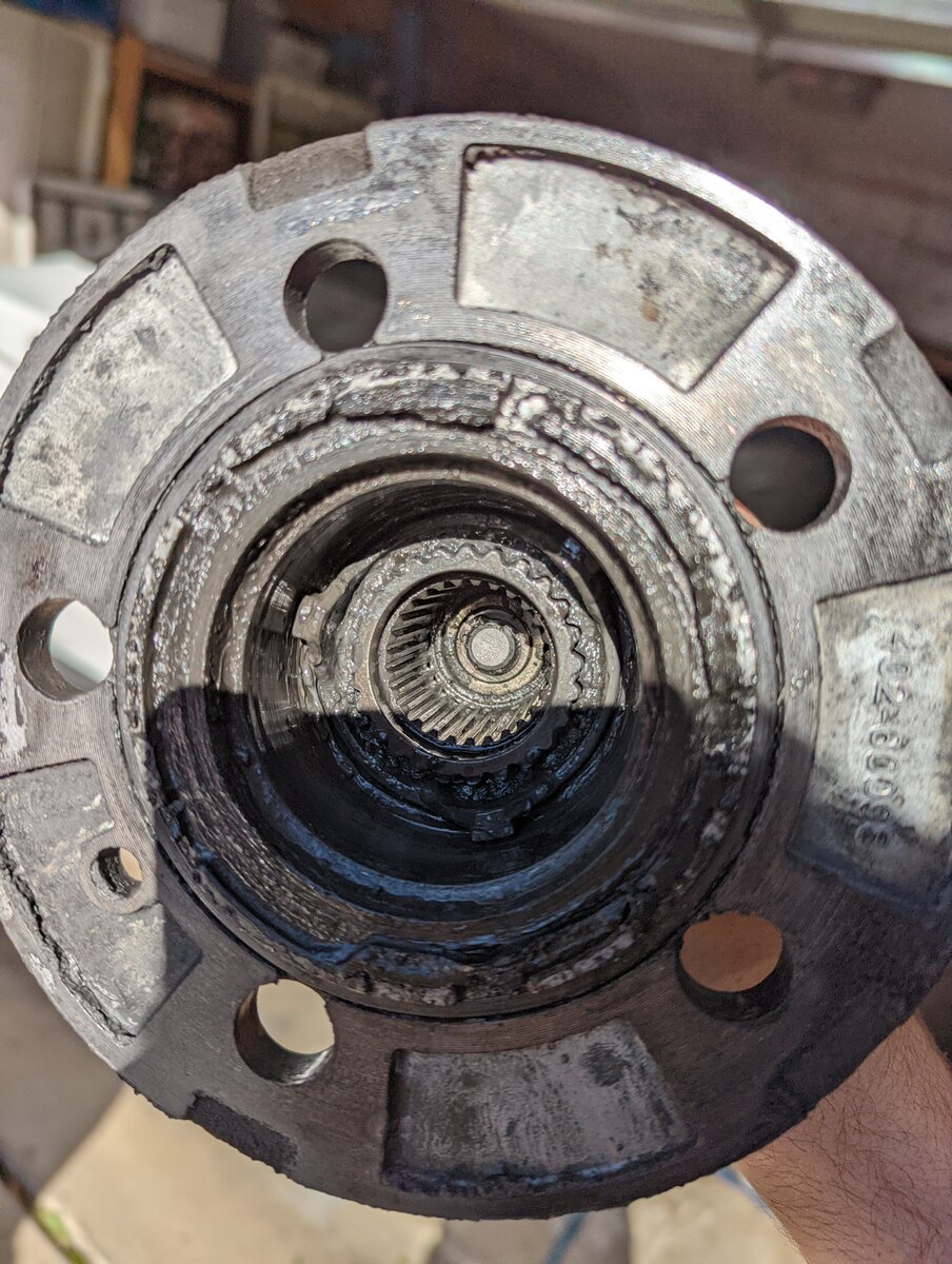

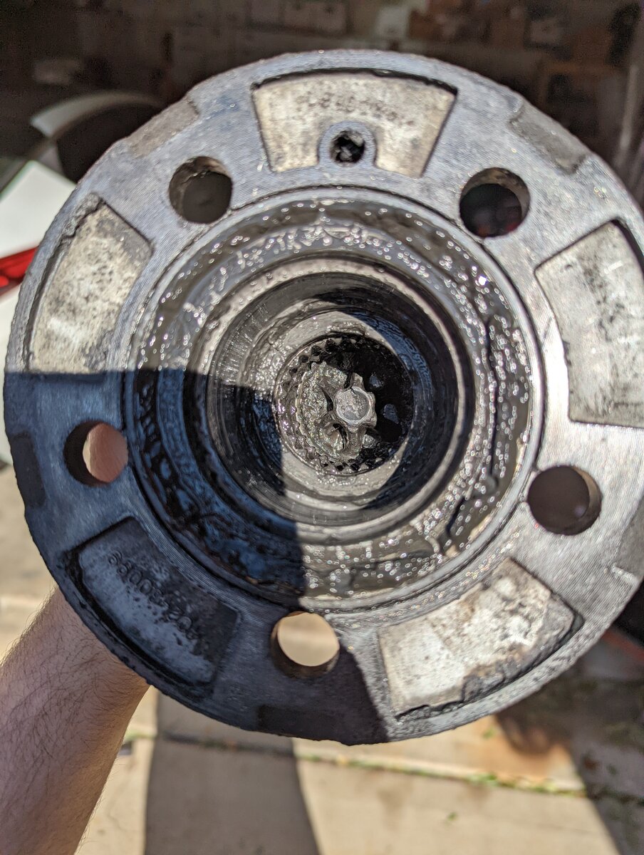

Oh yep. One side is definitely ****ed, however this isn't the side that's making noise. This side wont engage, and is quiet.
This side however would only grind when I put it into 4wd.
I think I'll just save up for manual hubs because they honestly don't look that expensive anymore. Do I just buy the manual hubs off rock auto for $100 a piece?
View attachment 425180View attachment 425181
