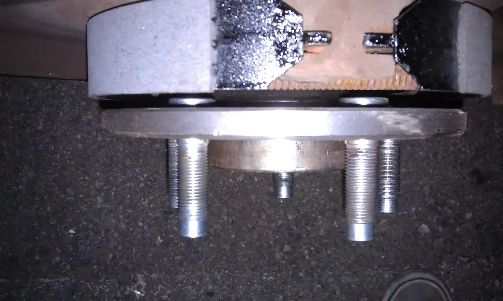

Well I decided to go ahead with this swap since my stock rear end started whining really badly. I had the shafts machined to keep a 5x4.5" bolt pattern though. Turns out I don't have any interference between the back of the axle flanges/studs and any of the parking brake components. I did have a bit of trouble getting the c-clips on the shafts for some reason and getting the shafts to spread back out and getting the pin to turn around, but once I did that there is plenty of clearance. I did also grind down one part of the parking brake lever and the back of the studs on one shaft in anticipation of interference, but there ended up not being any.
Picture for proof:
So basically, except for machining the shafts and cutting off the Bronco spring perches and shock mounts, it's a bolt on swap. I didn't even need to modify brake lines at all, I just stretched the stock hardline a bit. Will have more pictures when I finish.

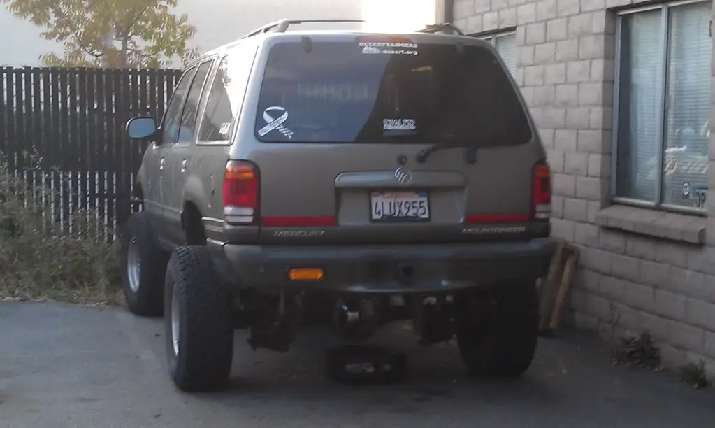

Oh ya, and I had the flange turned down to avoid interfering with the bevel inside the brake rotor parking brake area, so I didn't need to use washers either. Been driving it to work the past 3 days and it drives just like it did before. Here's a picture for others to see how it looks under the truck.
