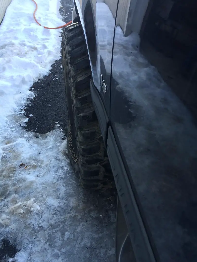

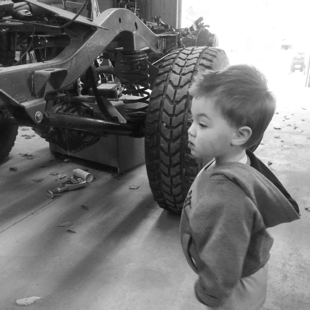

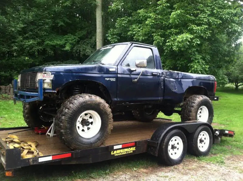

Snuck out of a family function for a few hours this weekend. Motivation has been renewed.

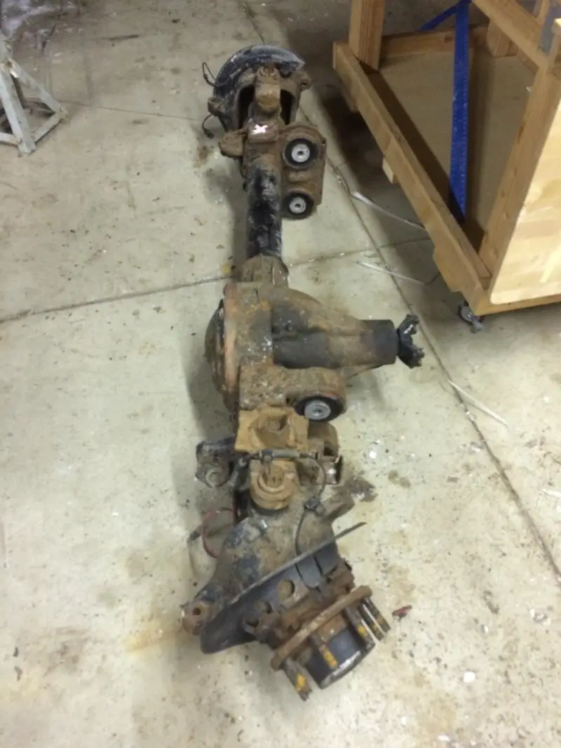

That is the truck I normally wheel with. 4.0L, 1354 doubler, D44, 8.8, 5.13s, 38s, Reid knuckles, RCVs, Ox lockers, OBA, etc

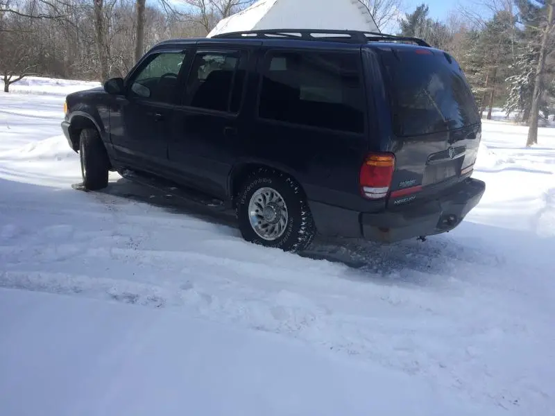

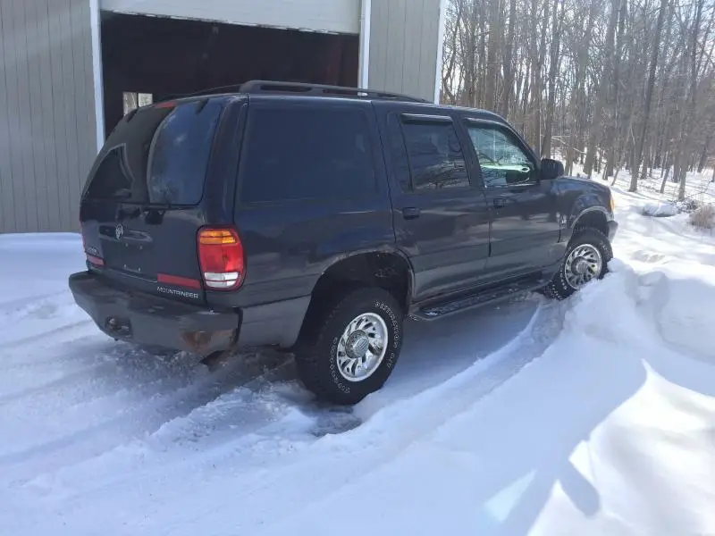

New Years Resolution: Work on this dang thing! I need to get this thing rolling this year. December 31 2016 marked 2 years of ownership.

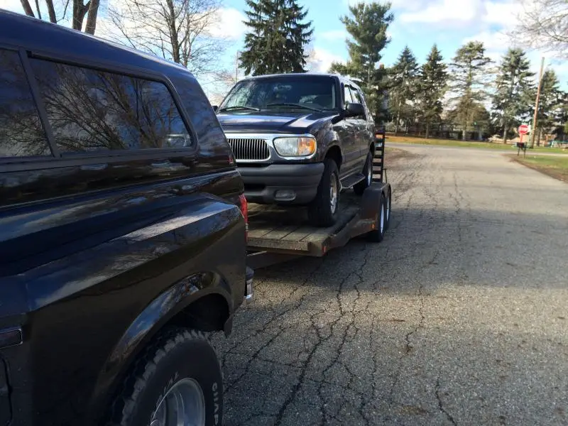

I bought a house in December. My last house. Moved this thing once again. No steering, brakes or power adds to the challenge. But nonetheless, its home.

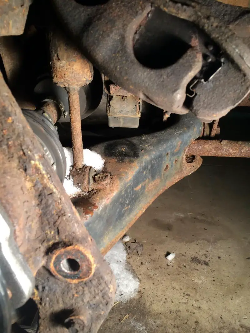

Started cutting off the OEM trans x-member brackets and ditched the OEM fuel tank. Dont mind the Ohio Rust...
