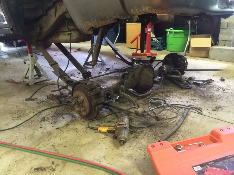

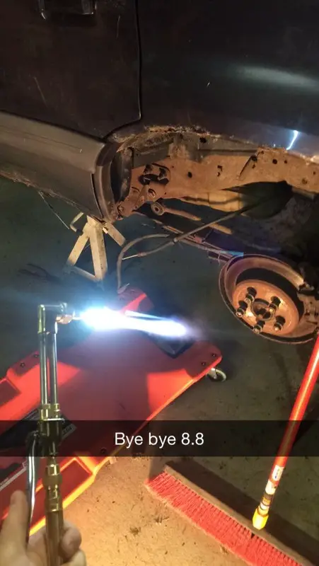

I got 2 hours of free time today. So I took the 8.8 out.

The only thing I havnt removed is the OEM shocks. The upper bolts are heavily rusted. I didnt deal with it yet.
All the "weight" that was removed
Rolled a 42 up to it. What did I get myself into.
For now I am going to rock rear leaves to get back on the trail faster. I will link it some time this decade. This is the 10.5 sitting under it.
Going to order some u-bolts tonight and maybe get the new perches on before the holiday.

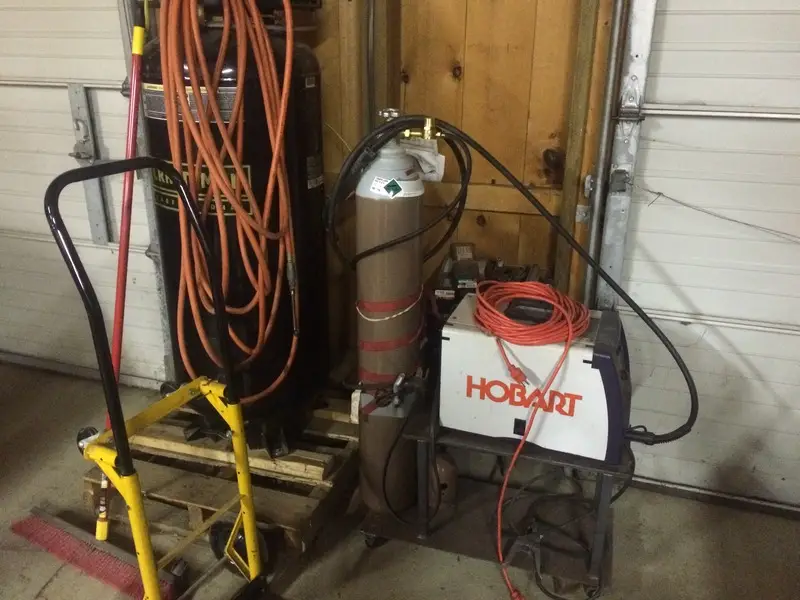

I got a 220V welder last fall of CL. Finally got a tank for it last weekend. I still have not used it though. I need to weld some new D-rings to my goose plate on my dually. Would be a good first project.

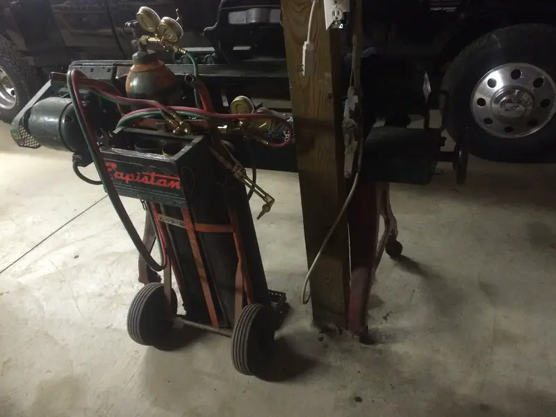

Got my free set of torch tanks all set up finally. Got some mid range gauges. Last thing I need is a new blade for the band saw.

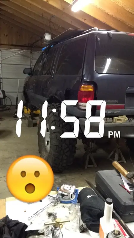

Teaser pic
Here are some more pictures

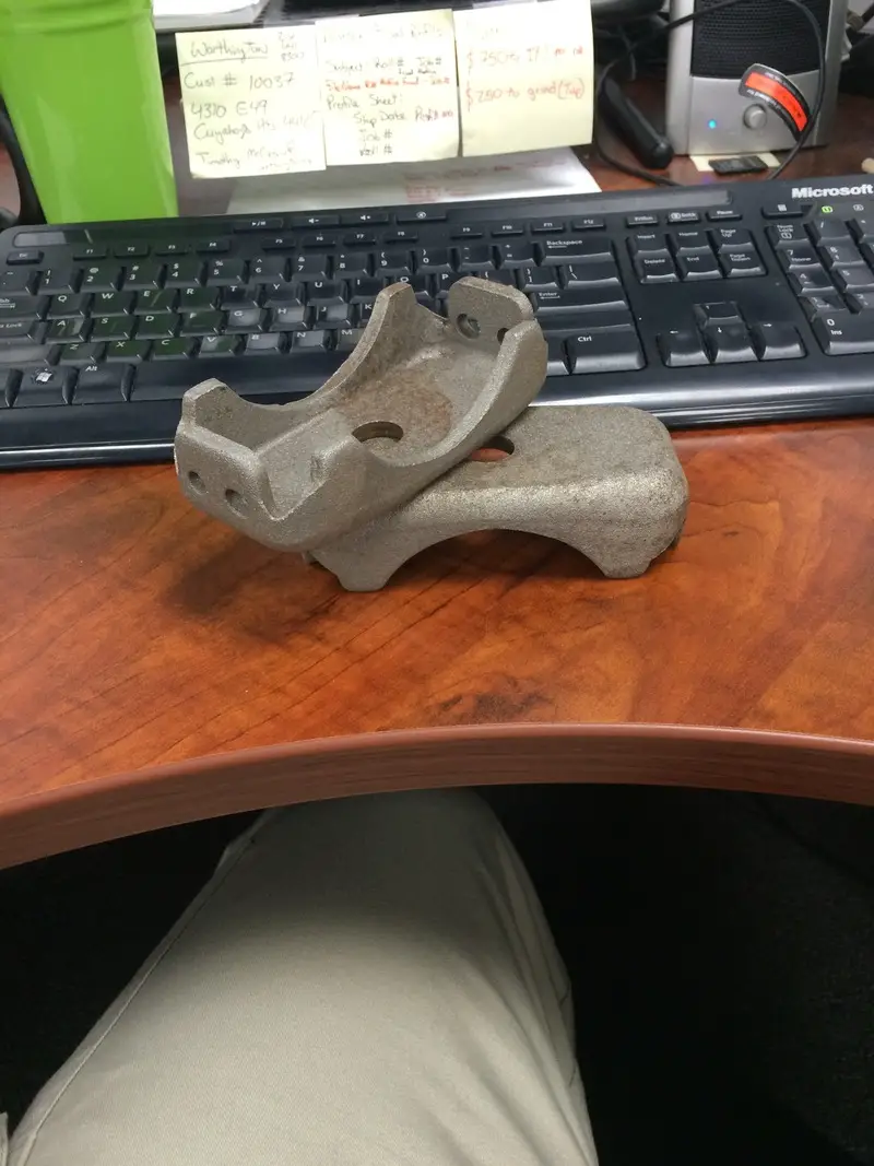

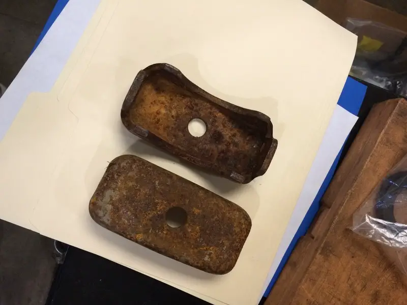

Took the new to me perches to work and had them blasted

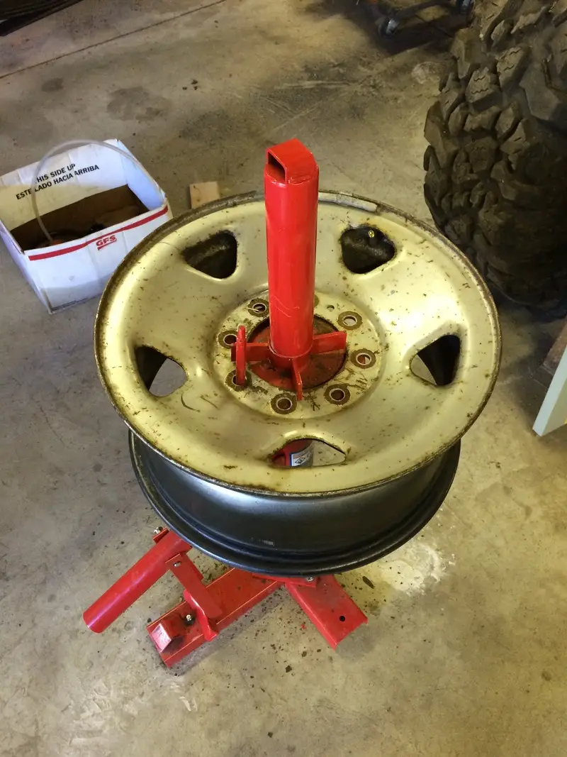

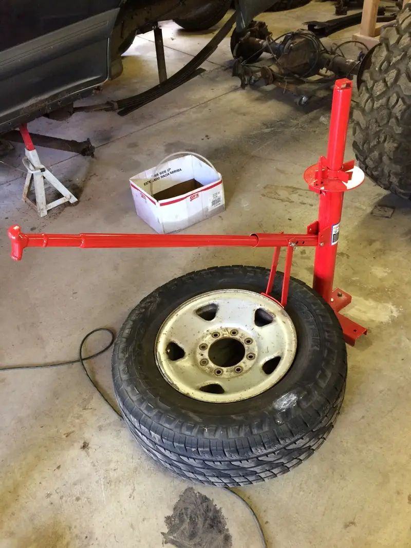

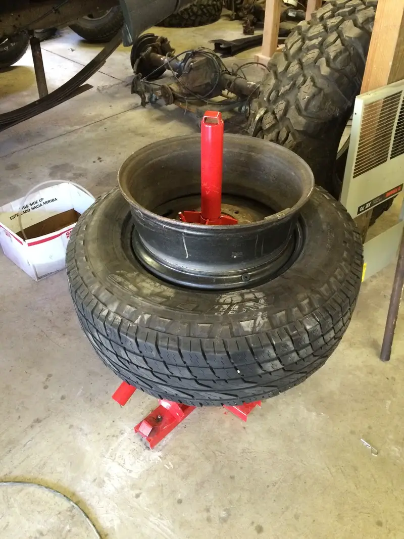

Then my aunt found this new Harbor Freight tire changer at Goodwill for $10. I had her grab it. Why not.

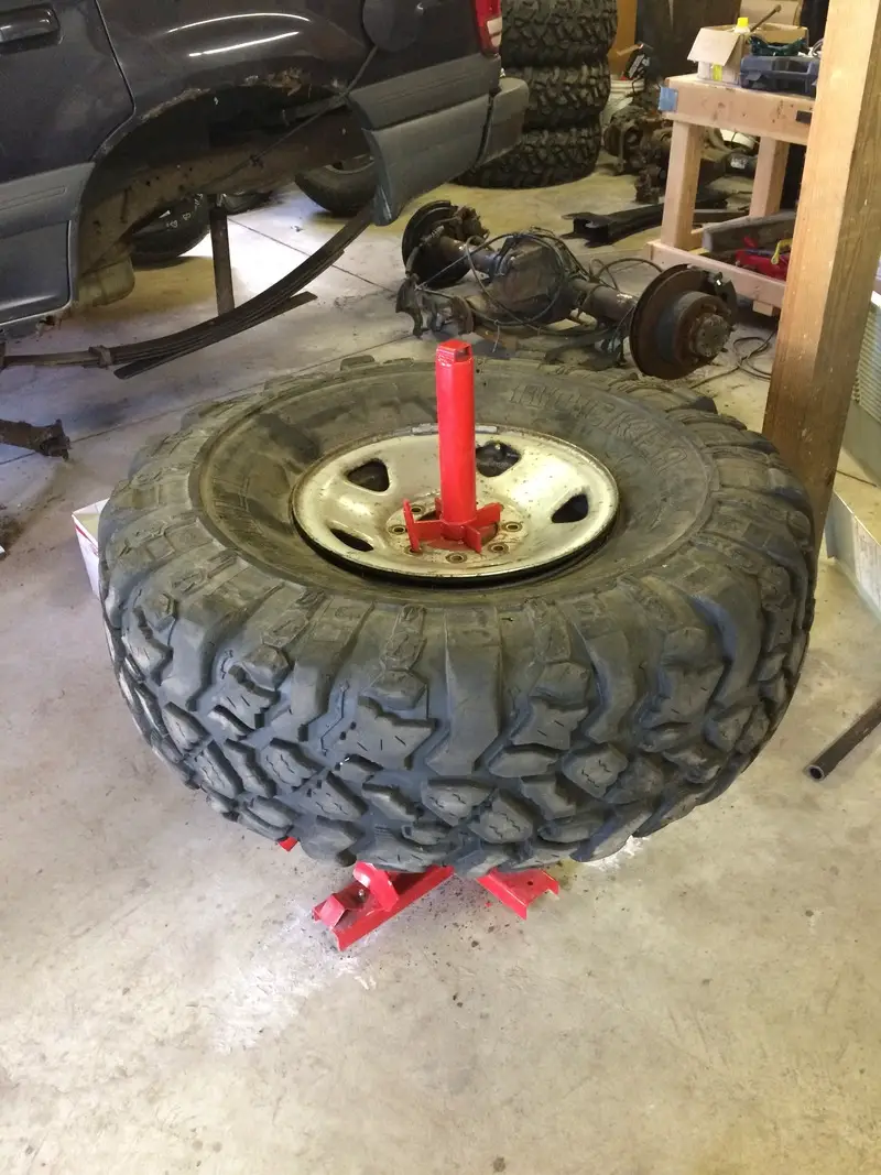

Put it to work getting these truck tires off the 08 17" steelies I have. Bent a few of the tubing right off the bat. I replaced them with strong tubing as needed. It wasn't easy, but it worked and saved travel time and money.
Also pulled all the mountaineer tires off its wheels and put them on CL for $100. Sold the next day.

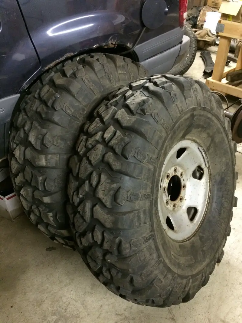

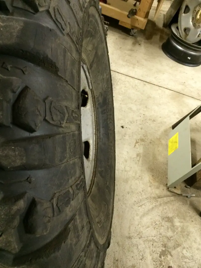

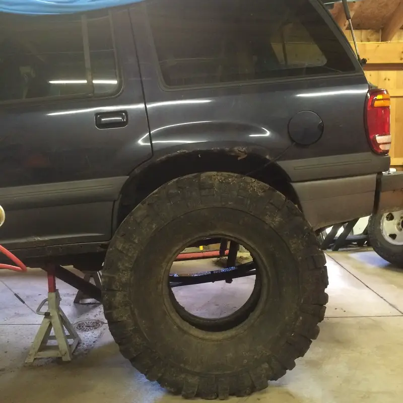

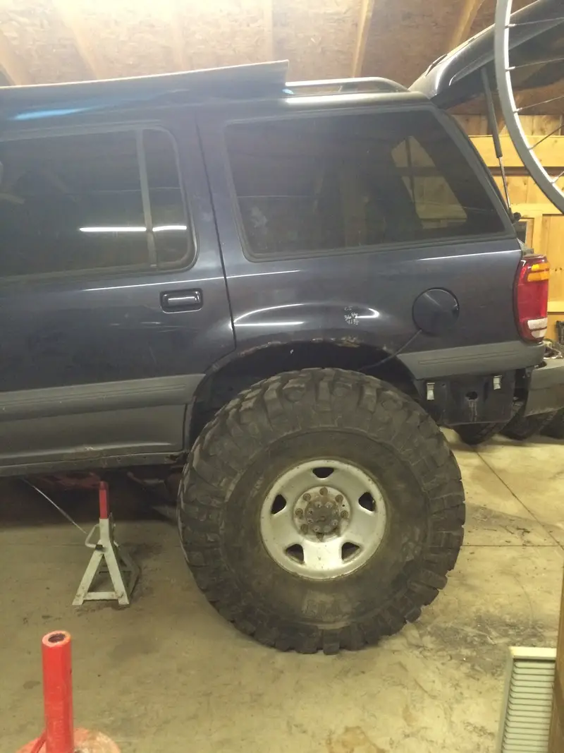

So the Pitbulls are 42x15. The stock 08 wheels are 7-3/4" wide. Not ideal but it will work for mocking this thing up. Plan is to weld on some bead locks which should add about 1". Two are currently mounted at 25 psi to get the bead to seat. They are bubbly haha.

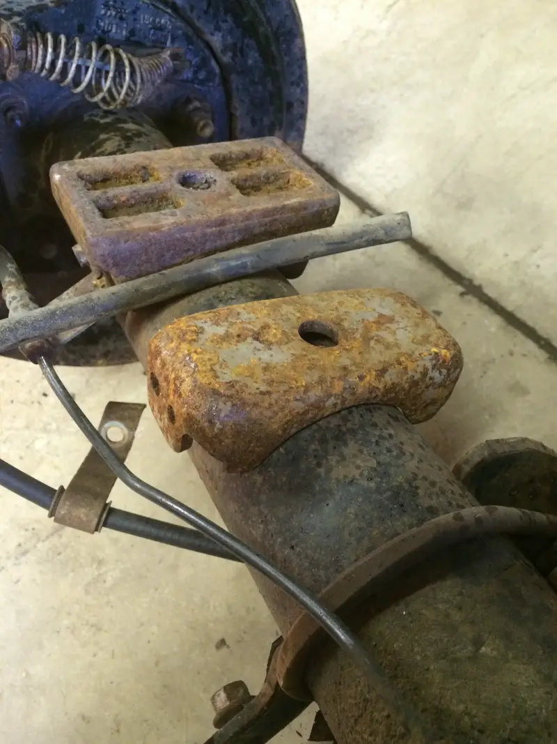

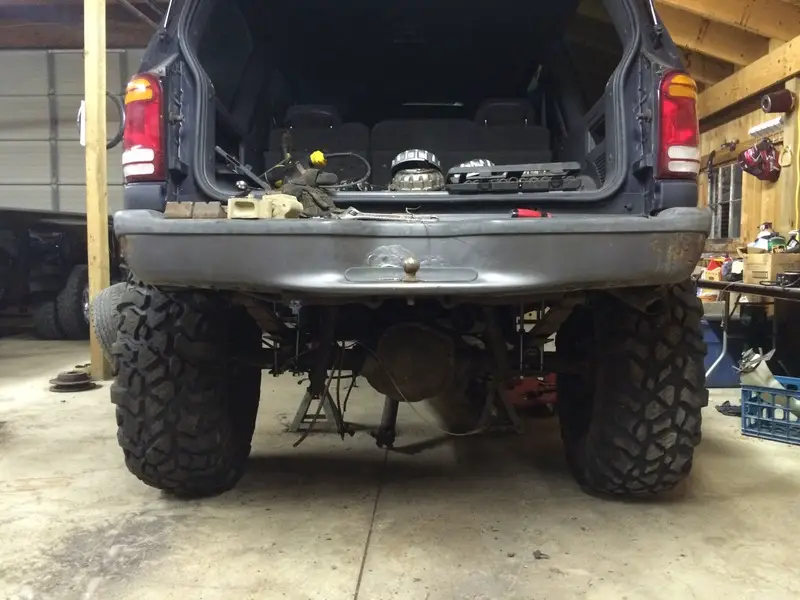

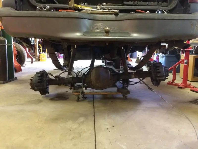

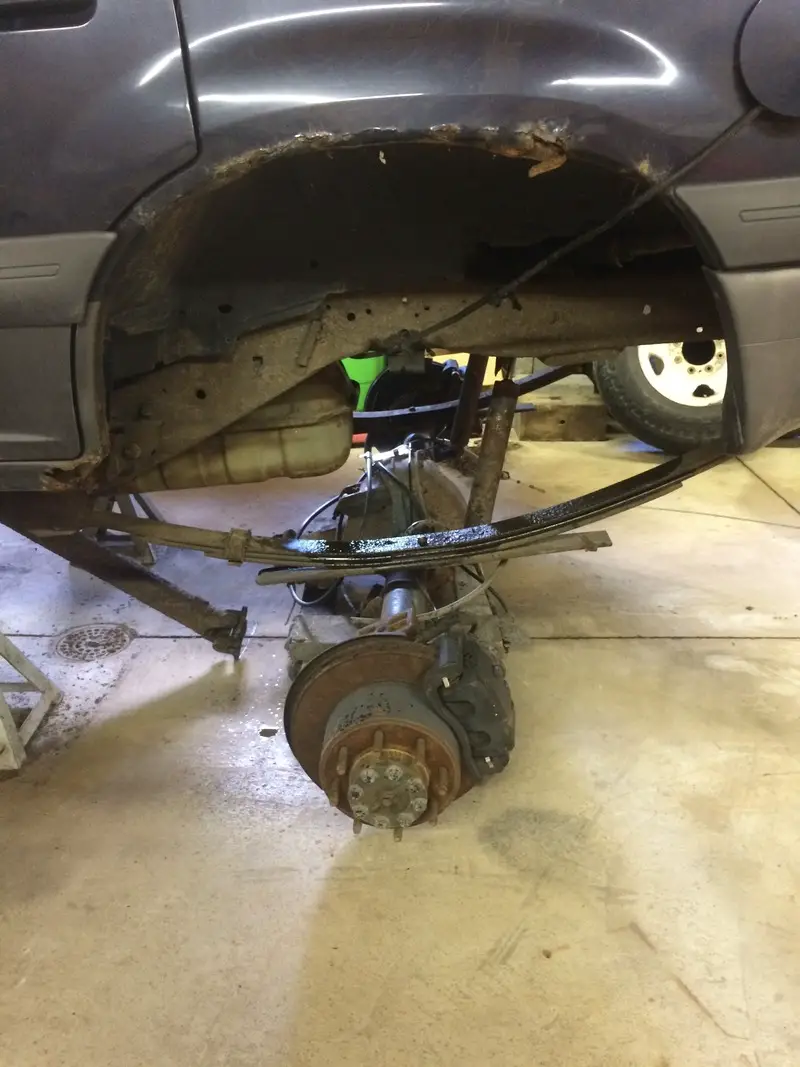

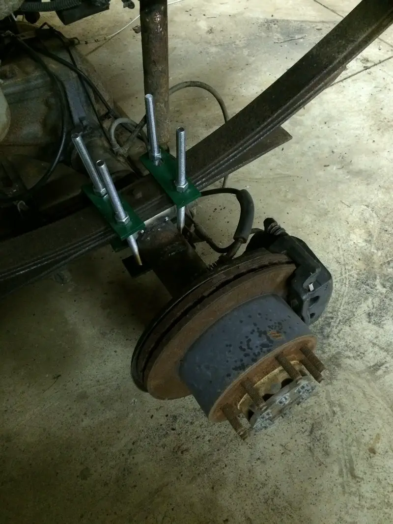

Last night I decided I couldn't wait to see where this thing would sit. So I tacked the perches on and threw the axle under there. Pinion angle is currently 10*. It will probably need a bit more. Time will tell.
I don't have U-bolts yet so I used some threaded rod for the time being. I will be ordering u-bolts next week.

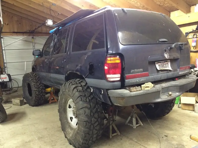

This is how the rear end is sitting. Suspension is 100% stock Mountaineer. All I have done is flipped the axle under the leaves. I like where it is height wise. I want to be as low as possible. I will need to trim a lot and I plan on moving the rear back 3-4" to clear the rear doors better.
I am happy with this stance.

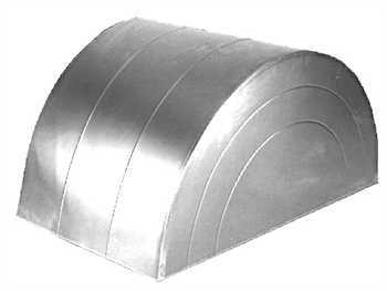

:salute: Much easier, Just cut the thing completely out and re-tub.

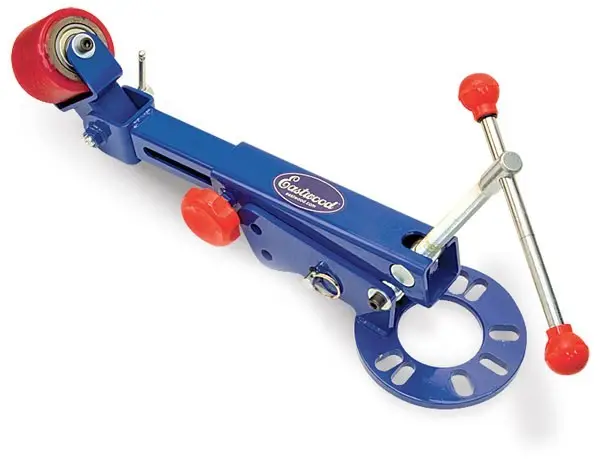

To make it disappear all professional like: Eastwood fender roller! Oh yea..... . If you shop around your local body shops you may find a guy willing to rent one out for a day or two.
http://www.eastwood.com/ew-fender-roller-w-instruction.html
Of course on the Ex you'll have to roll the door bottom too, a little creativity there but doable.
I had the same door issue when tub'n a 66' Chevy II.
I just cut out the arc right through the door and let the tub be the new gasket surface.
I used a large trunk seal on the edge of the tub so that when the door is shut it just presses against the seal. 1/8" flat bar to sturdy it up. Done.
To re-skin the inside of the door I just flush riveted aluminum sheet to create the new inner skin. Sand bag and mallet to form the aluminum.
Just some ideas to rattle around...

You have my brain rolling. I am not a body guy. I havnt figured out how I am going to make the door work. Originally, I was going to move the axle back, but there is not a lot of room to do that with leaves and the arc wouldn't look right. I plan on linking it back there, but as phase 2 or 3. And I like the OEM wheel base even though I will be moving the front axle forward.
But now I see cutting the door is possible. I was skeptical because I need it to seal as I would like to drive this on weekends with my kids in the back. I have friends in the ricer scene. They have fender rollers. After looking at my door, cutting a larger arc is not impossible. I will have to get their 2 cents.
I am pretty sure I will be going that route with the new tubs.
Do you have any pictures? I wonder if anyone has done it with a 4 door on here. I will have to dig around.

They make 42" tubs as well. When you call them ask which is recommended for 42" tires.
I wouldn't cut until you have the tubs in hand.
They also supply paper templates to get everything lined up before you go ape with the 24" sawzall blade. (pneumatic sheers recommended for the outer skin) and leave it long so it can be rolled.

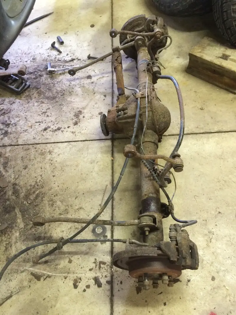

Pulled the front bumper. Welded some bracing across the frame that isn't shown. I attempted to remove the IFS via a reciprocating saw without disassembling the IFS. Decided its faster to disassemble then cut.
One side is apart...
This is the first IFS vehicle I have worked on where the upper arm was easily removed. Go figure since I am cutting it up...
The fun part is that I sort of wrench old school. Haven't been using impacts or other power tools because I work on this at night after my family goes to sleep. I have to wrench quietly. It adds to the challenge.
